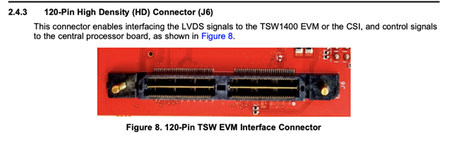

I know we can easily attach them two together, but I plan to place the mmwRF+DevPack on top of a car while TAW1400 cable connected. I can see the samtec is used for 1-port connection, is there a kind of cable do 2-port connection.
Best
Jet

Hello Jet,
The details for the cable are mentioned in the mmWave Dev Pack User's guide. Please refer to the linked documentation carefully.
The DevPack documentation refers to a cable length of 8 inches, but longer cables may indeed be used, like 12 or 16 inches. Generally, these cables are custom orders and may be ordered directly from Samtec.
Ishita
Hello Jet,
Section 3.2.2 (figures 18 and 19) of the user guide mentions about the part number of the 120 pin cable used with connection diagrams.
Here is the part number : 120-pin Samtec cable (HQCD-060-08.00-TBL-SBR-1-D)
Is this not what you're looking for?
