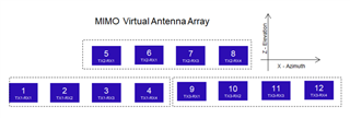

I want to process the .bin format raw data to seperate them to vitrual antenna data.
So far, I have done is processing the raw data to [num_frames, num_chirps, num_rx, num_adc].
I want to seperate the num_chirps to  num chirp per loop * num_tx, which make it able to seperate each virtual antenna(like below picture) data from it.
The raw data I captured is from ethernet in OOB demo.
My configuration files are bellow:

profileCfg 0 77 267 7 57.14 0 0 70 1 256 5209 0 0 30
chirpCfg 0 0 0 0 0 0 0 1
chirpCfg 1 1 0 0 0 0 0 4
chirpCfg 2 2 0 0 0 0 0 2
frameCfg 0 2 16 600 20 1 0
