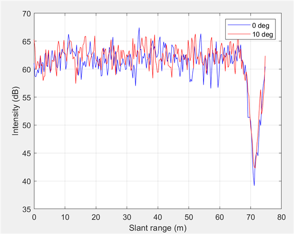

I am using the MMWCAS-DSP-EVM + MMWCAS-RF-EVM kit. I experience a signal drop in the outer 10 % of the range.
I use the advance frame configuration to create the frames. The radar scans a sector from -60 to 60 degrees off-boresight in steps of 2 degrees.
Here are the main parameters I use to configure the radar from a Matlab file. Tell me if you like the JSon files.

Main steps in signal processing
  1. FFT in range dimension
  2. FFT in doppler dimension
  3. Perform beamsteering towards the angle TX steering angles
The first figure is a heat map plot of a sea surface, showing cross range versus down range (both horisontal) of mean doppler.
The second figure shows two single directions, 0 and 10 degrees off-boresight, from figure 1, but in slant range (antenna height = 5 metres).
I understand this is a tricky and complex question with probably to little information, but do you have any idea about what causes this problem?
