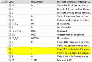

    Good point with the critical section, which I had also already suspected, however I disabled the IRQ(value=1) and FIRQ(value=1) bits in the Current Program Status Register (CPSR) before I run the code above and disable them afterwards. so this cannot actually be it, unless this is the wrong register.

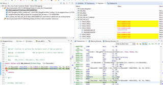

    Also the HWA_paramDoneISR Interrupt is a good point, but in the demo code (C:\ti\mmwave_sdk_03_05_00_04\packages\ti\datapath\dpu\rangeproc) only a HWA_allParamDoneISR interrupt is thrown and in this interrupt routine the status register in the HWA will not be reset and during further debugging the status register is only set to 0 when the HWA_reset method in the DPU_RangeProcHWA_config is called.

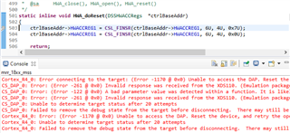

    But is it possible to put a breakpoint in HWA_doReset in the HWA driver? Because after jumping to line 503, the demo program crashes:
    What I did instead was to set a breakpoint before and after the HWA_doReset and there I could see that the internal HWA state was cleared in the Demo.
    But yes, I'm not sure if the HWA_doReset is executed in my Code.

    To the problem that I can put a breakpoint in HWA_doReset, but the program terminates after a second due to a memory read error (this happens exactly after this line: ctrlBaseAddr->HWACCREG1 = CSL_FINSR(ctrlBaseAddr->HWACCREG1, 6U, 4U, 0x7U)):
    I add a global counter which will increment in the HWA_doReset. However, after executing the HWA_reset method, the counter was increased. Therefore the HWA_doReset should be executed.

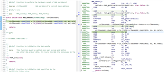

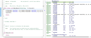

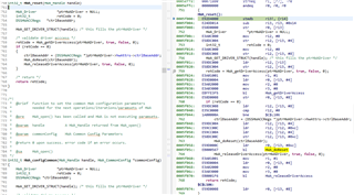

    In my further analysis I compared the assembler instructions of freeRTOS(left) with the TI Demo(right):
    I'm not that good with assembler, but what I noticed was that when I execute HWA_reset, there is another jump to HWA_doReset and also other registers are used (maybe for optimisations). But could this be a problem and how can it solve?
    I also checked, before the HWA_reset is called, that the HWA is disabled, but also this is implemented in the DPU_RangeProcHWA_config and is also executed by checking if the global variable is incremented and the ACCENABLE bits are set to 000b:
