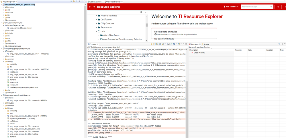

I have a compilation error. I didn't have it earlier. Please take a look at the screenshot.
I don't see any dependency files missing.
and
Please let me know what should be done. I want to debug and view the registers and ROV on real time data.

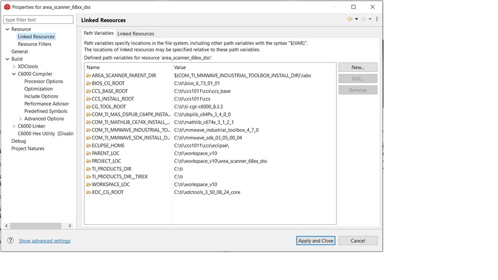

    I have a problem in building the project. I could successfully build the project for the area scanner demo but not for the long range demo. I'm getting the error for the area scanner and not long range. If you can see the screenshot I have the .bin file for long range and not area scanner.
    So what is the reason for the error in the area scanner demo to build?
    Divya
  • Divya:
    1. I would suggest downloading the industrial toolbox directly into your machine e.g. C:\ti and import the CCS projects instead of using the resource explorer.
    2. What version of CCS are using?

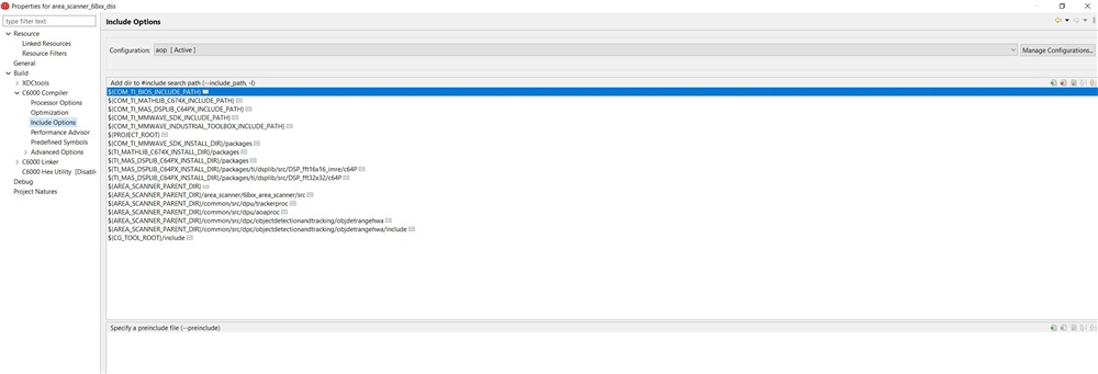

    3. In the project explorer notice in the DSS project notice that you have [Active - ods]. You are using IWR6843AOP, this is not correct. Please read the user guide. It specifically calls this out.

    There is some miscommunication here. I’m trying to build the project in CCS for that a sensor is not needed to be connected to the system. I build the demo project and it should give me binary files of ODS atleast. I did the same for long range. I didn’t connect the ISK to build the project. For debugging yes I would do that but my project isn’t even building so I can’t go to the debugging.
    I’m using version 10.1.1 code composer studio

    You have to use CCS version 8.3.1 as specified in the user guide.

    Thanks for the reply. I have downloaded the exact version you mentioned and built the project and it is the same error again. Please check the screenshot below.

    What version of the mmWave SDK are you using? I just built this project in the ODS configuration using Industrial Toolbox 4.7.0 with no issue.

    I'm using mmWave SDK 03.05.00.04 version and Industrial Toolbox 4.7.0. Even I didn't have a problem earlier and also no problem with Long range. It is happening with area scanner.

    Have you modified any files (either intentionally or accidentally) in any of your projects? Some projects will link their files back to the originals, meaning altering a file in one project could break your other projects. Those are the correct versions, so I think a clean install of both the SDK and toolbox would correct your issue.

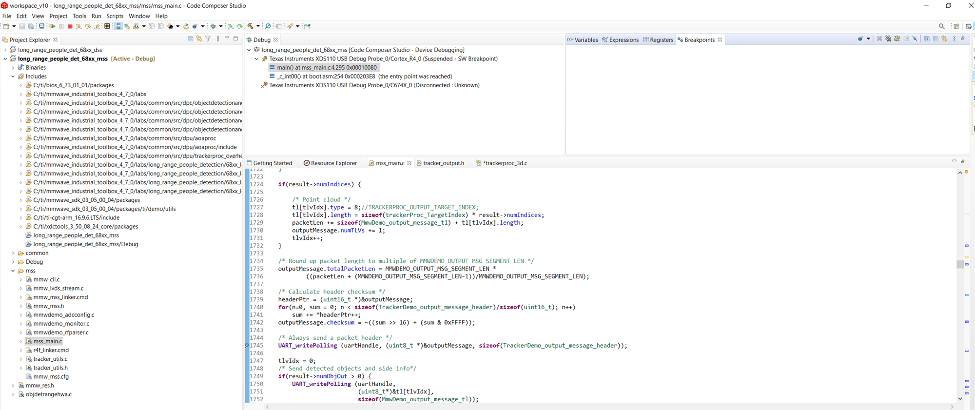

    I would try it out for the area scanner and let you know but I could build the project for the long range demo as mentioned earlier and I'm having trouble with the debugging. As soon as you launch the debug mode why is it the pointer is always not starting at main(). That is definetly one question I have here. Because it is so random each time I launch the target configuration and also when the pointer starts with main() I'm having trouble with adding breakpoints for debugging. I need guidance with that as well. I would be glad to hear it from you supporting some documentation abou the debugging and breakpoints. I'm trying to view the data that is sent to Matlab from the sensor which is in turn through UART displayed on GUI. Thanks in Advance.
    Divya Teja Settimali
  • Divya,
    Do you have the CCSDebug image flashed onto the device already via uniflash?
    Alec
  • Yes I already did flash the CCSDebug image flashed onto the device.
  • Divya,
    Are you doing a reset between each load in CCS?
    Alec
    Yes, also tried connecting multiple times after reset. What is the difference between following this debug procedure in mentioned in this link Using CCS Debug for Development (ti.com) and then loading debug mode directly on clicking the debug option in the CCS? Because loading the debug mode directly in the CCS works or starts at main() most of the time.
  • Divya,
    I haven't encountered issues following the steps in the guide you posted, and am not sure if there are any issues with the debug button, so if it works for you then I would say carry on. Were you able to resolve your build issue for this project?

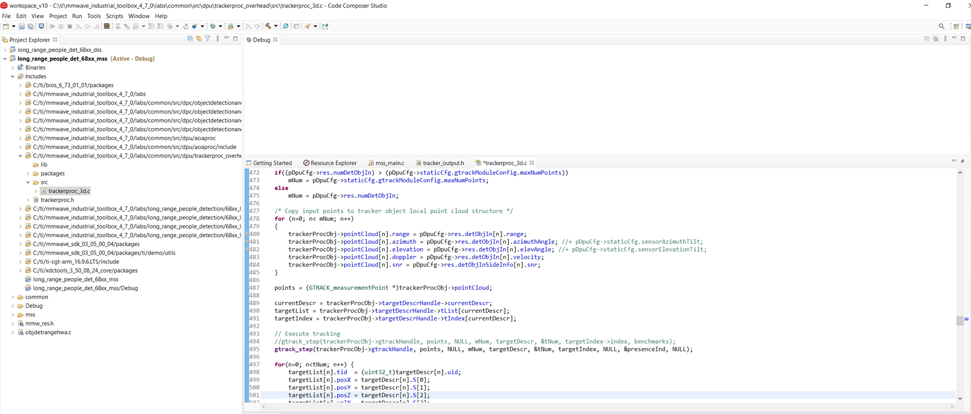

    2. Can I make changes in the libraries or the common files that are available?
    For example I want to make changes in the trackerproc_3D.c
    I wanted to remove the comments in the lines 481 and 482 and add tilt but despite of removing the comments and compiling it didn't work.

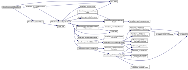

    3. I wanted a break point to view the result variable and I put a hardware breakpoint.
    but debug never goes into that function at all and to check the flow of the code I need multiple hardware breakpoints and multiple hardware breakpoints are not supported. I was following the below flow diagram.
    I hope I'm clear with the questions and would wait to hear from you. Could you let me know if I'm missing something or didn't follow something right.

  • 1. The goal of the debug image is to ensure the device is in a known state for CCS. If it is working fine without it for you, feel free to continue at your own risk. You can view the documentation for this at {MMWAVE_SDK_LOC}/packages/ti/utils/ccsdebug/docs/doxygen/html/index.html
    2 + 3. Any library that we have provided source code for can be rebuilt locally. This serves two purposes, it lets you make changes specific to your project, and it allows you to step into those source files while debugging. To enable this, you will need to do two things.
    • Remove the libs that you want to rebuild from the project linker settings.
      • project properties->ARM Linker->File Search Path and then remove whatever libraries that you want to rebuild from the top field "Include library file or command file as input"
    • Add the source files that you want to rebuild to your project
      • This can make your #includes a bit challenging as the paths may change, so I recommend making the file path in your project match that of the file's normal location
      • Example: if you see "#include common/src/dpu/trackerproc_overhead/trackerproc.h" then I would create the folder common in your top level of your CCS project, then the sub folders for src, dpu, and trackerproc_overhead, and then store the .h file in this folder so that you do not need to update all the include paths.

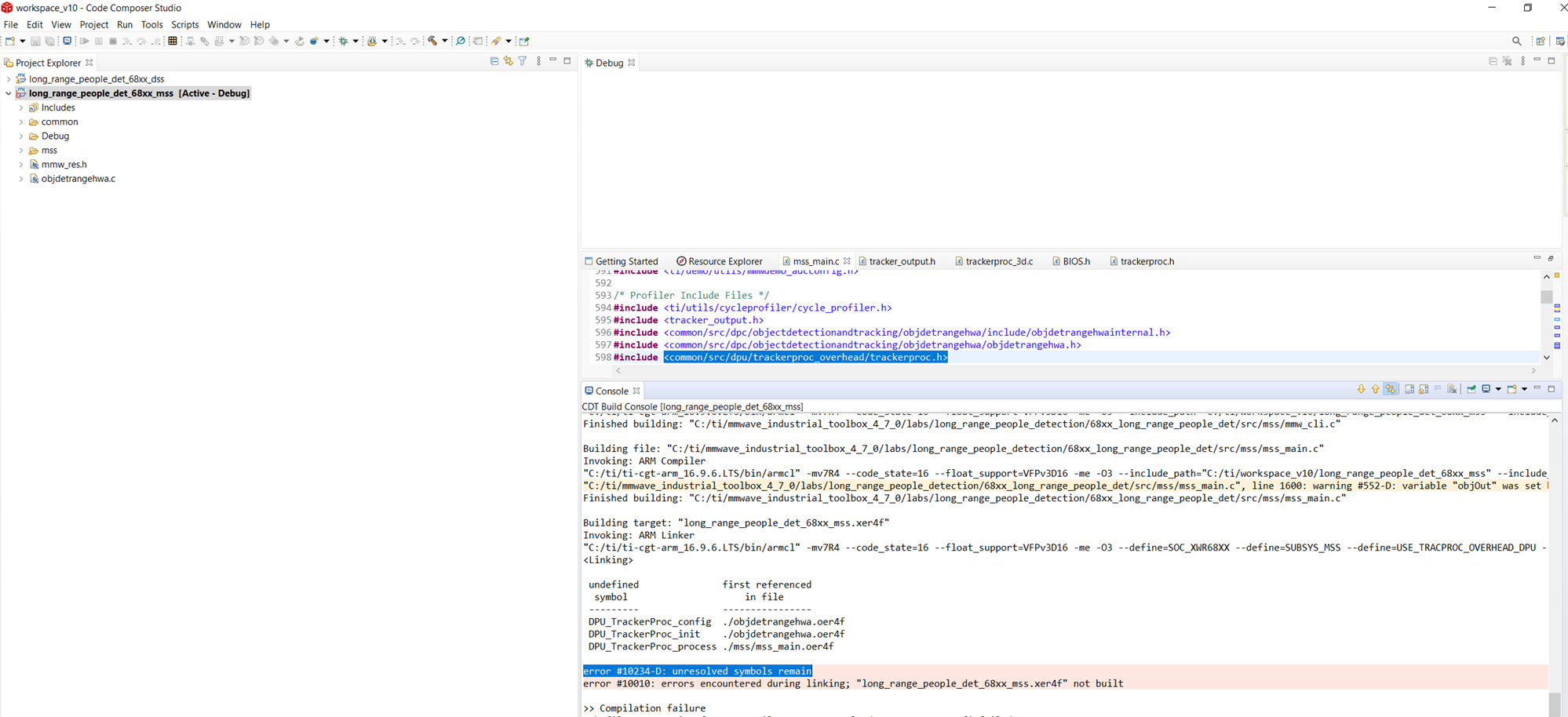

    Thank you for the reply. So I have raised another post with the question as suggested. Here when I'm trying to rebuild the libraries locally it gives an error from the screenshot. Could you let me know how to get rid of it?
  • Hi Divya,
    I just built this on my end with no issue, have you modified anything in your copy of the mmWave SDK or the Industrial Toolbox that could cause this to occur? Additionally, if you click on the project and go to properties->Build->ARM Linker->File Search Path, do you see "libtrackerproc_xwr68xx.aer4f" listed in the top box and "${LRPD_PARENT_DIR}/common/src/dpu/trackerproc_overhead/lib" listed in the bottom box?

    I did make a change in the library and so deleted the lib that I wanted to rebuild and added the include path according to your previous post.
    After this I see the error and I do not know what to do further.
  • Divya,
    Okay, I was just trying to get on the same page on where we left off since we went on a tangent a bit. So the issue indicates that your trackerproc source file isn't getting built locally and therefore the symbol is not getting resolved during linking. I believe this is due to the fact that you put them under includes, can you try organizing the files in your project like in the screenshot below?
    Alec
