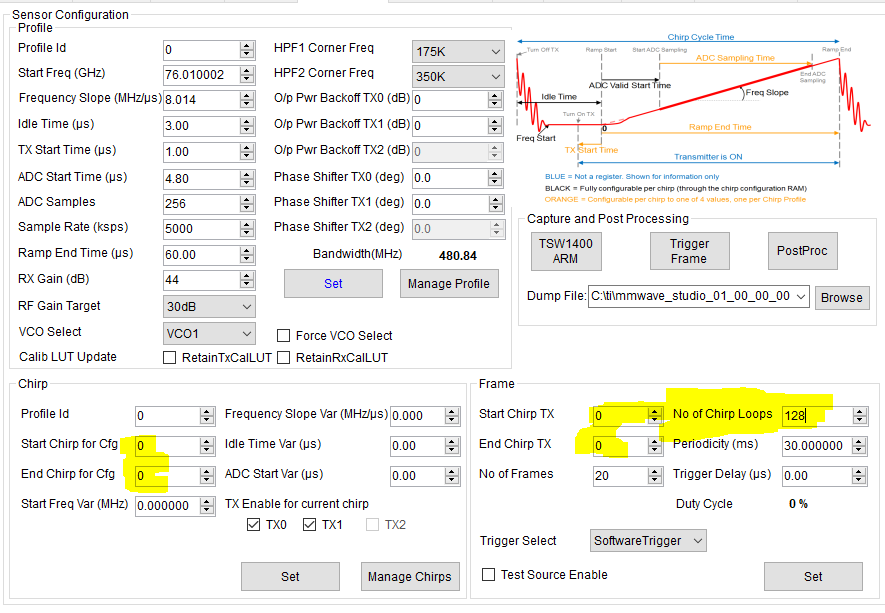

                                                                                                              (1) method 1
                                                                                                                              (2)result of method 1
                                                                                                                                      fig 1

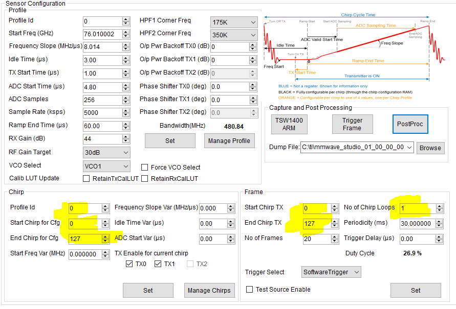

                                                                                                          (1)  method 2
                                                                                                                          (2) result of method 2
                                                                                                                                         fig2

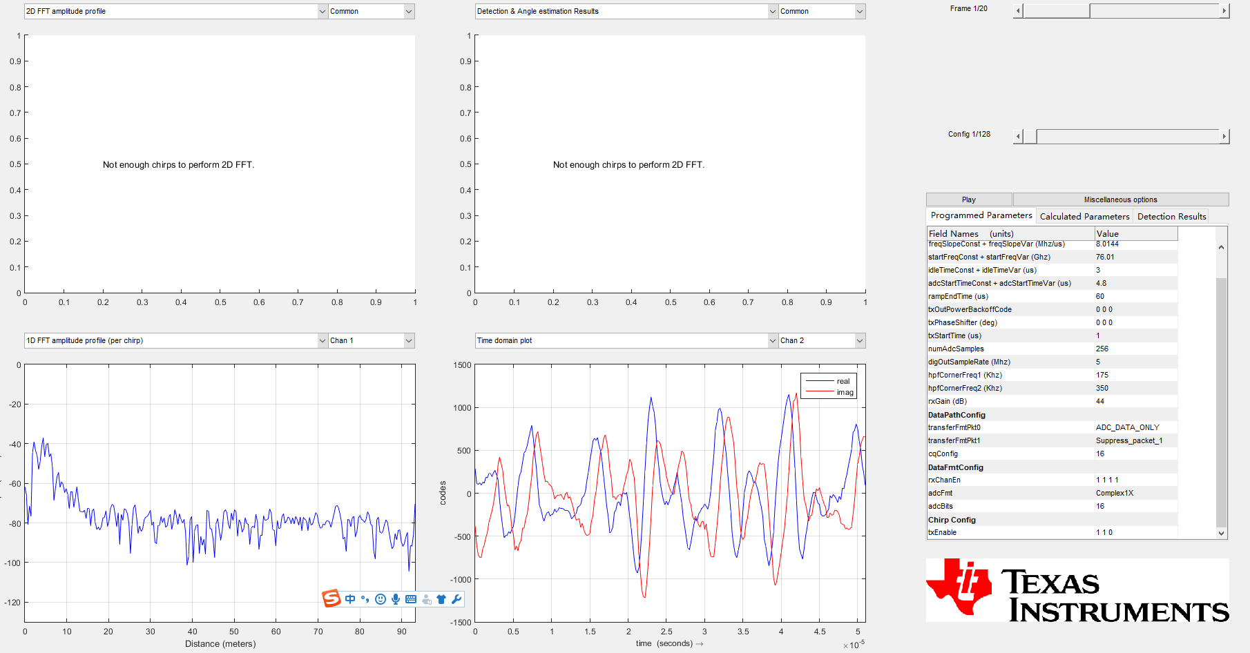

 i am using AWR1642+TSW1400 to capture adc data.
When i post process adc data using mmwave studio , i find different result, seeing fig1 and fig2.
I ues 2 different way to config a frame. the frame has 128( same )chirp.
 method1 is fig1. And after postproc, i get 2D FFT Amplitude profile, Range-Angle plot,Detection & Angle estimation Results and so on.
But methor2, i can not get 2D FFT Amplitude profile and Range-Angle plot.... PostProcessing tells me "not enough chirps to perform..."
Where am i wrong?
The method2 is a wrong config frame way?

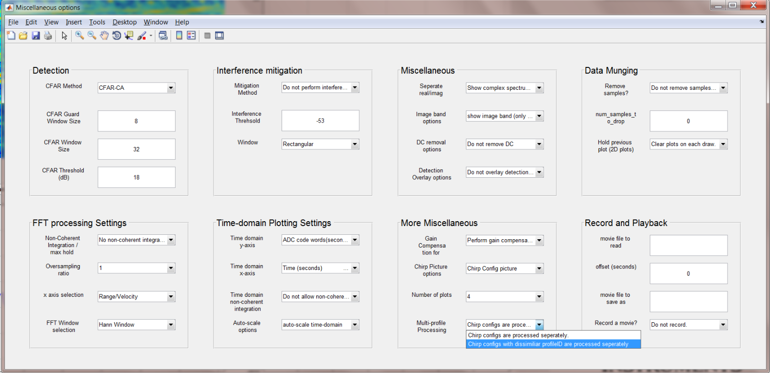

  • Hi Rongjiang,
    After confirming with our mmwave studio designers I think I have an answer for you. When you construct a frame using chirp-profiles the post processing script does not assume that every chirp is identical in construction. There is a feature in the post-processing GUI meant to support cases like yours where the chirps are identical, or you just want to ignore differences in chirp to chirp construction. This is under ‘Miscellaneous options’-> ‘More miscellaneous’ tab. The option is called ‘multi-profile processing’. See excerpt below.
    Selecting the option "Chirp configs with dissimilar profileID are processed separately" should let you process both frame constructions.
    Please let me know if that answers all of your questions on this topic.

  • thanks Randy.
    follow your steps in Miscellaneous options, i get the same result. But a few question i want to ask further to understand the principle.
