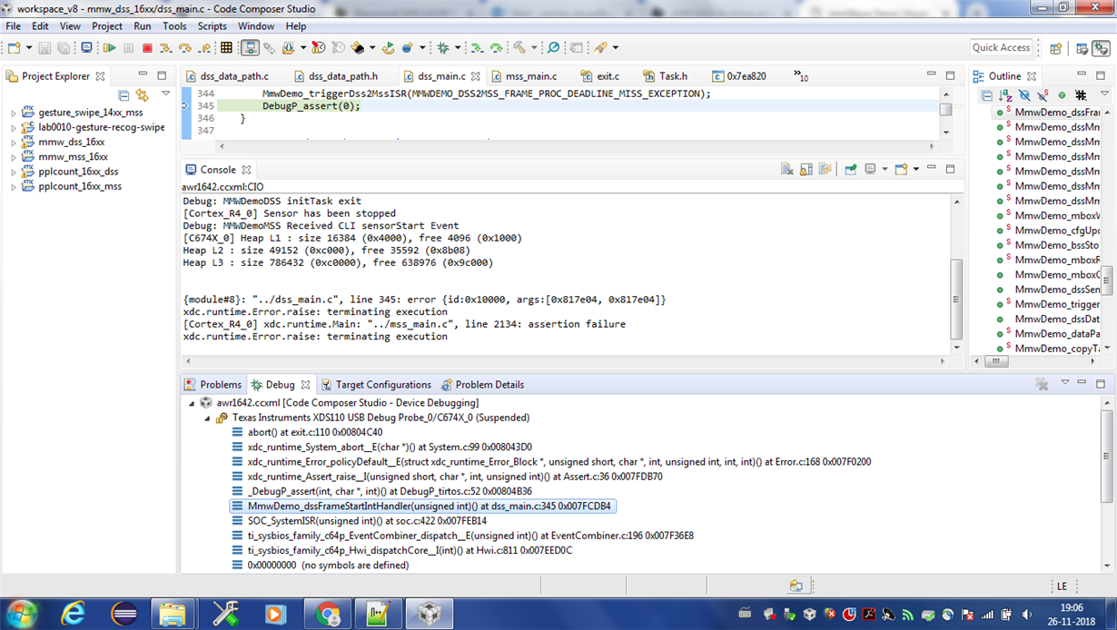

While executing the demo, after processing of some frames,  I get the following error:
In My_func: START
In My_func: END
In My_func: START
In My_func: END
In My_func: START
In My_func: END
In My_func: START
In My_func: END
{module#8}: "../dss_main.c", line 345: error {id:0x10000, args:[0x8182a4, 0x8182a4]}
xdc.runtime.Error.raise: terminating execution
[Cortex_R4_0] xdc.runtime.Main: "../mss_main.c", line 2134: assertion failure
Can I know what is causing the error? Why is it crashing after some time? Memory related issue?

  • Hi Varsha,
    If added new code eats up some time and blocks DSS there then while doing the FFT for chirp/frame it may hit the assert in the chirp/frame-intHandler function where it check if last chirp/frame processing is done are not.
    So, please calculate new code time consumption.
    Jitendra
  • Hi Jitendra,

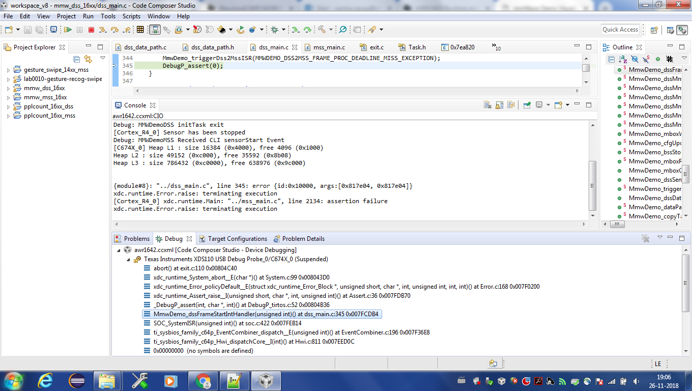

    Yes, as you said it hits the assert in the frame int handler & fails there. The code I have added is a plain function with no long processing, it just adds the 2 numbers & prints it.  I have used the _itoll(TSCH, TSCL); to calculate the cycles of the function.
    Following is the screenshot which shows my error:
    Can you please help me with this.
    Varsha
  • Don't add any system_printf (to CCS console), even though there is much code to execcute but printf to console function causes much more delay to execution flow. As for this print CCS intermettently halt the core and reads the value (if any) for printf, which effectively cause the delay and core will hit the assert.
    So, avoid adding any system_printf fuction when FFT processing is ongoing.
