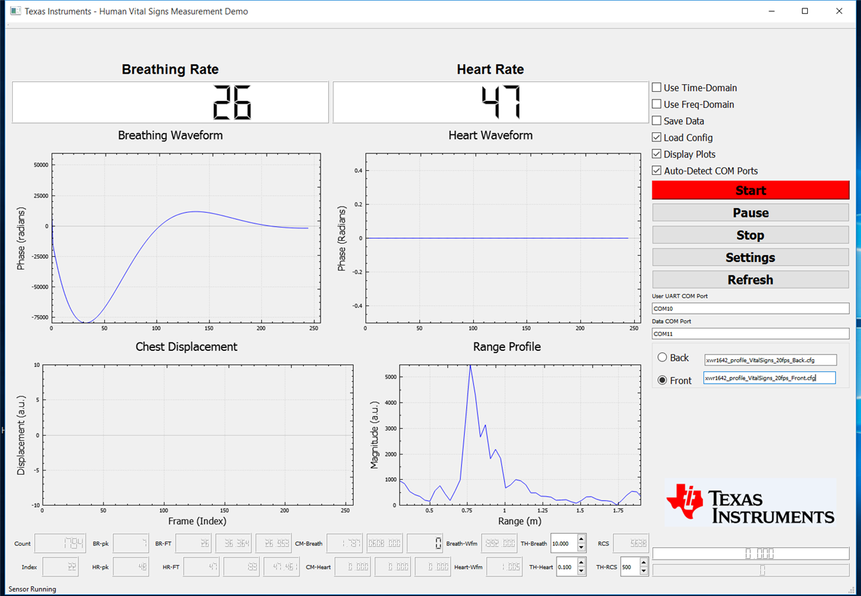

    I have tried all vital sign demo from Automotive Toolbox (AT)1.0. to 2.4.4 and none of these seems to work. I have got only one out of 4 of my IWR1642 got working on Automotive Toolbox 2.4.3 so for clarity let's take it vital sign demo is not working in AT 2.4.3. I am have flashed prebuilt binary of AT 2.4.3 to take few screenshots and made few observations.
    I am referring to my boards with their last three digits of the serial number and those are 1st IWR1642-> 583, 2nd IWR1642-> 538, and 3rd IWR1642-> 195. The IWR chip is same in all these boards and chip number can be found here in my another e2e post IWR1642BOOST: Which silicon version is this?
    I have observed many working and nonworking scenarios for all of these boards. These three boards worked perfectly on people count demo which makes sure that these boards are perfectly right. Thereafter I tested on AT 2.4.3 again to take some screenshots. [PS:  I have found the same behavior for all version of AT starting from 1.0 to the latest one but I am here attaching testing behavior of AT 2.4.3 only]
    1st Powerup After Flash
    538-> Only Range Profile was giving output other waveforms were almost zero
    195-> Waveforms of heart rate, chest displacement, and range-profile was working and breathing waveform saturated to some output around 2^30. (*1)
    583-> Only range profile was showing the right waveform and others were not being displayed.

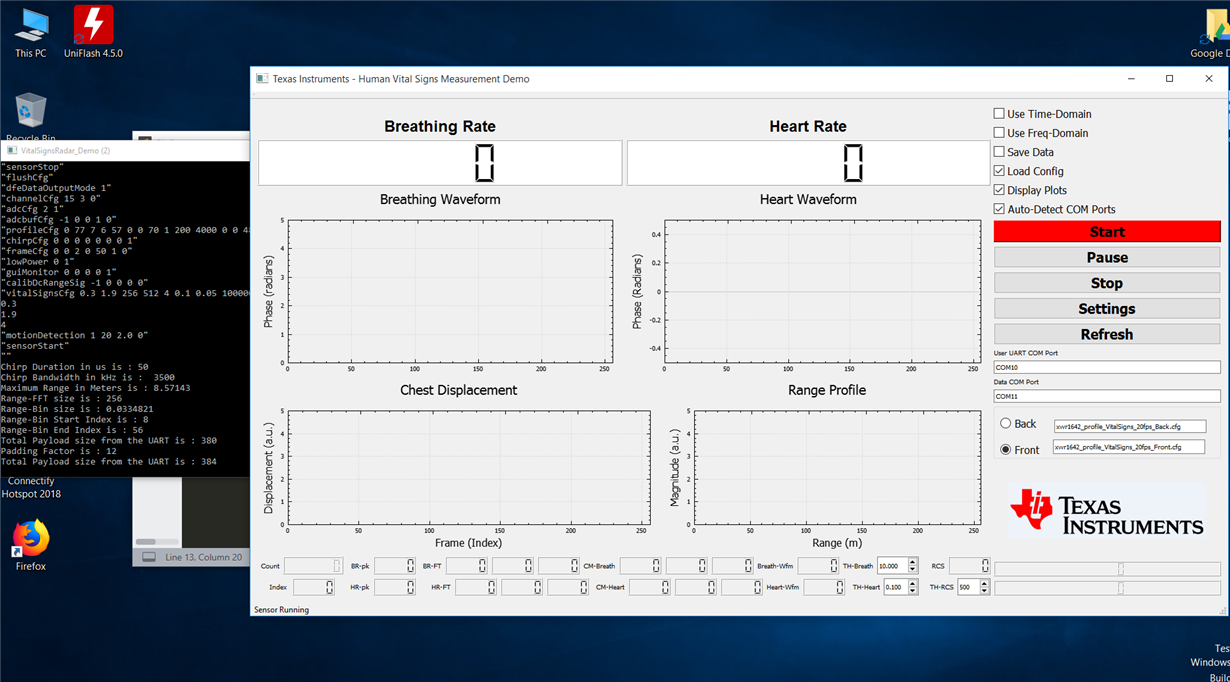

    Same behavior as previously but this time 195 got stuck after transmitting two frames, please see here vital signs demo UI shows nothing with IWR1642 BOOST

    Here are some screenshots for your reference, as I said earlier these behaviors are not specific to any of boards, these are being shuffle board to board after a power cycle.
    1st Power Cycle for  Board 195
    2nd Power Cycle of Board 195 (Stuck after transmitting two frames)

  • Laxmi,
    We have identified an issue in the source code that would result in the vital signs lab working correctly on AWR1642BOOST correctly but having an issue on IWR1642. This issue will be addressed in a future release. Please keep in mind that the release notes do state that this lab was designed for AWR1642BOOST.
    Kyle
  • Laxmi,
    We have identified an issue in the source code that would result in the vital signs lab working correctly on AWR1642BOOST correctly but having an issue on IWR1642BOOST. This issue will be addressed in a future release. Please keep in mind that the release notes do state that this lab was designed for AWR1642BOOST.
    Kyle
  • Kyle,
    Would you mind to let me know a little more about the bug and where do I look to findout if I can make it right. Is this bug comes randomly? I mean sometimes I get right data but some times not.
  • Laxmi,
    In the dss_data_path.c file under the MmwDemo_interFrameProcessing() function, make sure that all of the static variables are initialized to zero.
    Kyle
