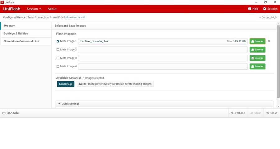

hello,
I'm facing a similar issue while flashing image file to AWR1642BOOST Using Uniflash tool as well as at Command Prompt
Below is the command Prompt:
D:\OEM\TI_mmwave\ti\uniflash_5.0.0>dslite flash -c D:\OEM\TI_mmwave\Inputs\mmWave\uniflash_windows_64\user_files\configs\awr1642.ccxml -l D:\SB127971\TI_mmwave\uniflash_windows_64\user_files\settings\generated.ufsettings -e -f -v D:\OEM\TI_mmwave\ti\mmwave_sdk_03_01_01_02\packages\ti\utils\ccsdebug\xwr16xx_ccsdebug.bin

And the Flashing got terminated with the below error
Connecting...
Loading Images
Initialization of uniflash object completed
Initialization complete.: 1%
info: Cortex_R4_0: Initialization complete.
Instance shutdown procedure activated...: 99%
info: Cortex_R4_0: Flashing process starting...
Done.: 100%
info: Cortex_R4_0: Connecting to COM Port COM3...
info: Cortex_R4_0: Reset connection to device
error: Cortex_R4_0: Serial port COM3 specified does not exist, is already open, or permission is denied!!
error: Cortex_R4_0: !! Aborting operation!!
error: Cortex_R4_0: Not able to connect to serial port. Recheck COM port selected and/or permissions.
info: Cortex_R4_0: Flashing instance clean-up initiated...
info: Cortex_R4_0: Instance deinitialized!
Failed: Image loading failed: Not able to connect to serial port. Recheck COM port selected and/or permissions.
Attached snapshot for the error displayed in Uniflash tool
COM Port is as per the Port detected as COM3. I've also tried with the full name but still I get the same error.
Please find the Setting made in Uniflash as below
Please provide the solution for the above issue.
