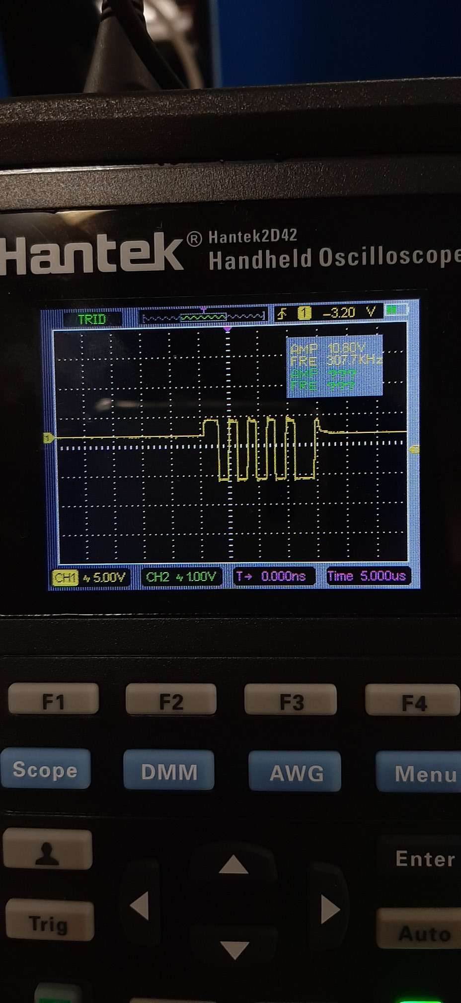

I'm using TDC1000 with 300 KHZ multifeed sensors.
I'm able to TX 5 pulses of 300khz with 10v amplitude .
but at receiving end i'm not able to receive signal.

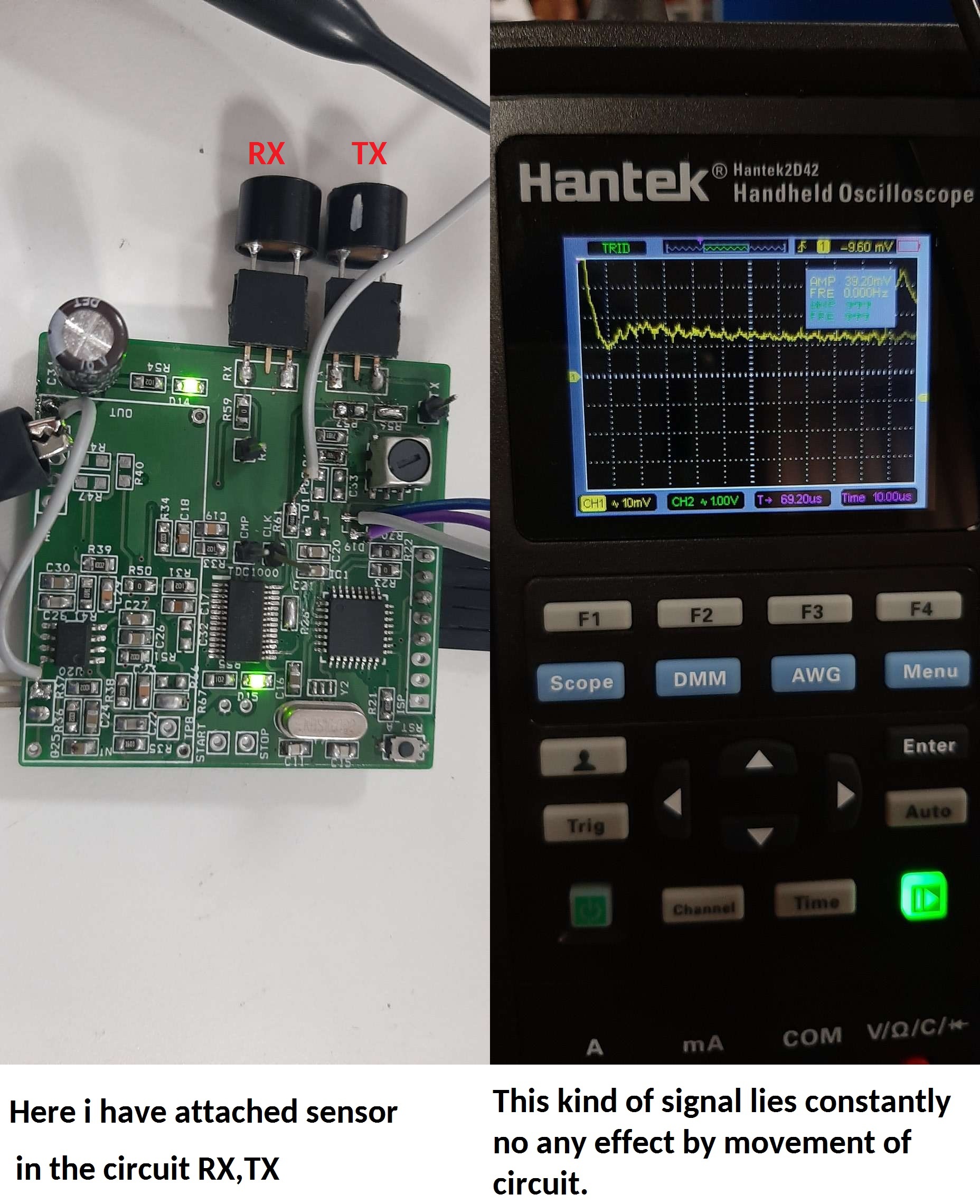

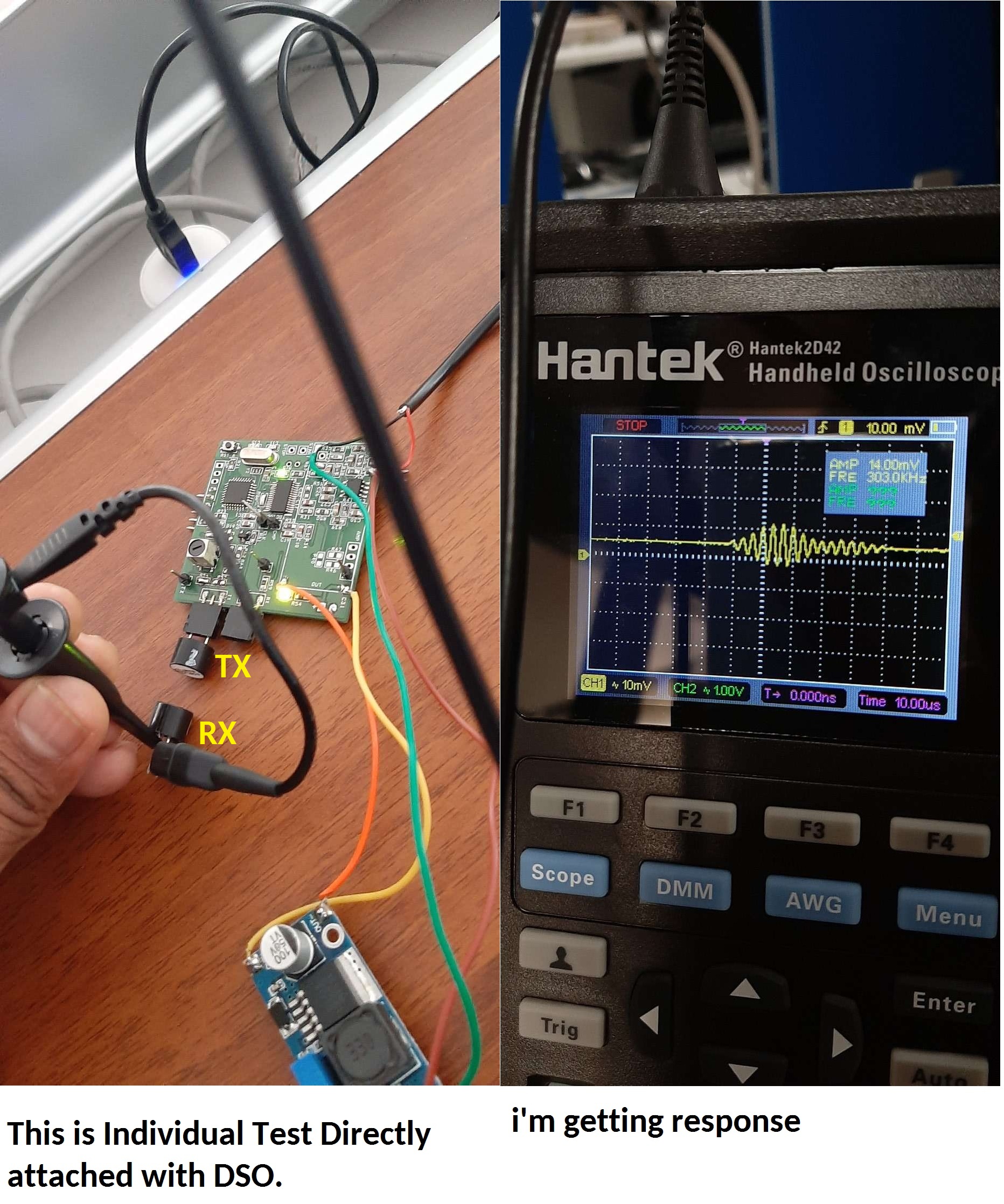

but when i attach that sensor individually directly with DSO probe then i'm able to receive signal of 10 to 20mV at 5 to 20cm distance.
but when i attached that sensor with circuit i'm not able to receive any signal even at same distance.
is it ground problem?or other
please help
