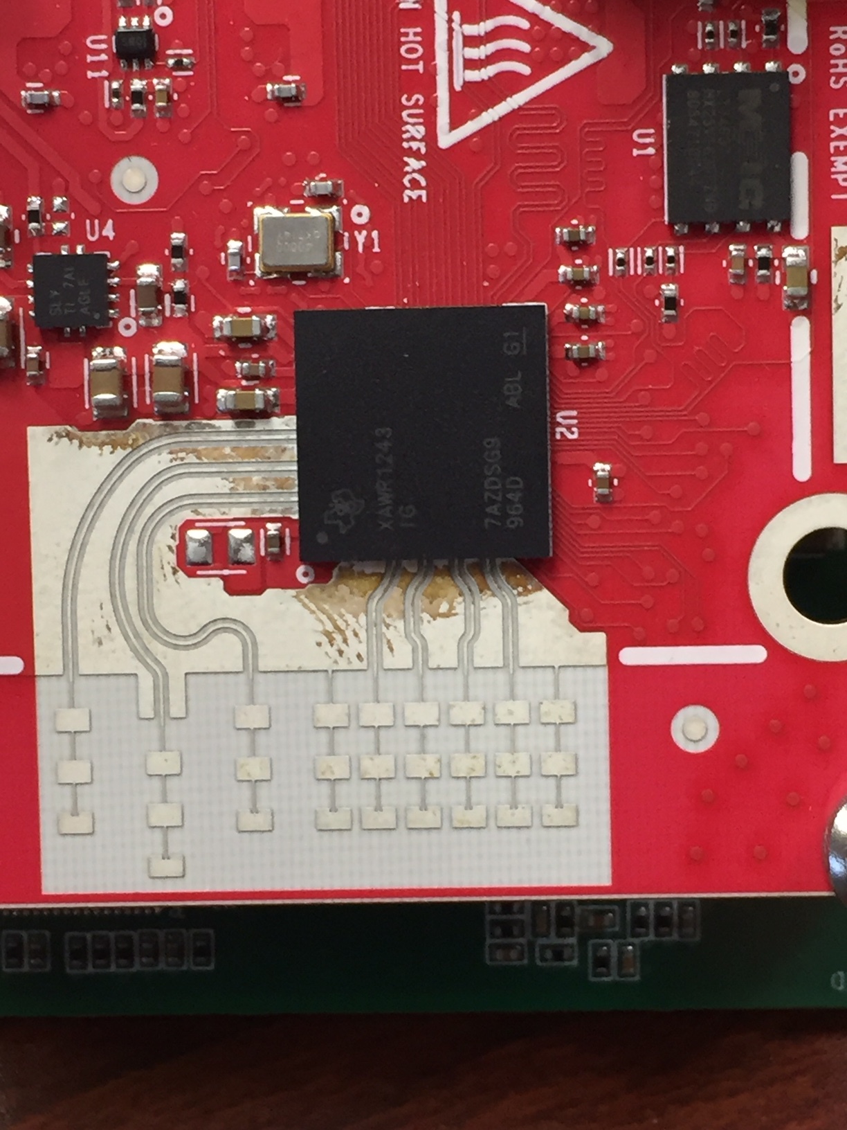

  • I believe I have an ES 2.0 device, after consulting "AWR1443: How to check for ES1.0 or ES2.0?"
    The chip on my AWR1243Boost board is labelled 946D, and I believe the D means that it is ES 2.0.
    I will try installing mmwaveStudio 1.0 next. Thank you.

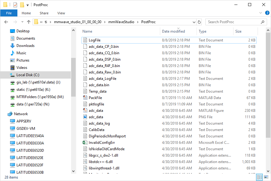

    I have two empty files named adc_data.bin and Temp_data.
    And I have a LogFile, which contains the following:
    02-Aug-2019 14:25:43: API:PowerOff,0,

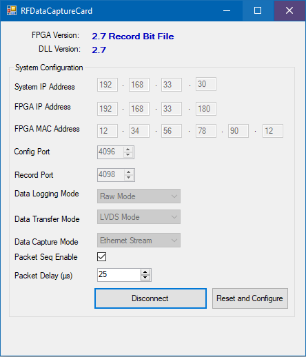

  • Hi Kyle,
    I was doing that because, the Radar API shows SPI Connectivity Status:  Disconnected
    So, I wanted to follow steps 1-5, to get SPI Connect complete.  These steps all work, but then the script fails.
    However, if I just issue the RS232 reset, then I get the output logs you find attached.

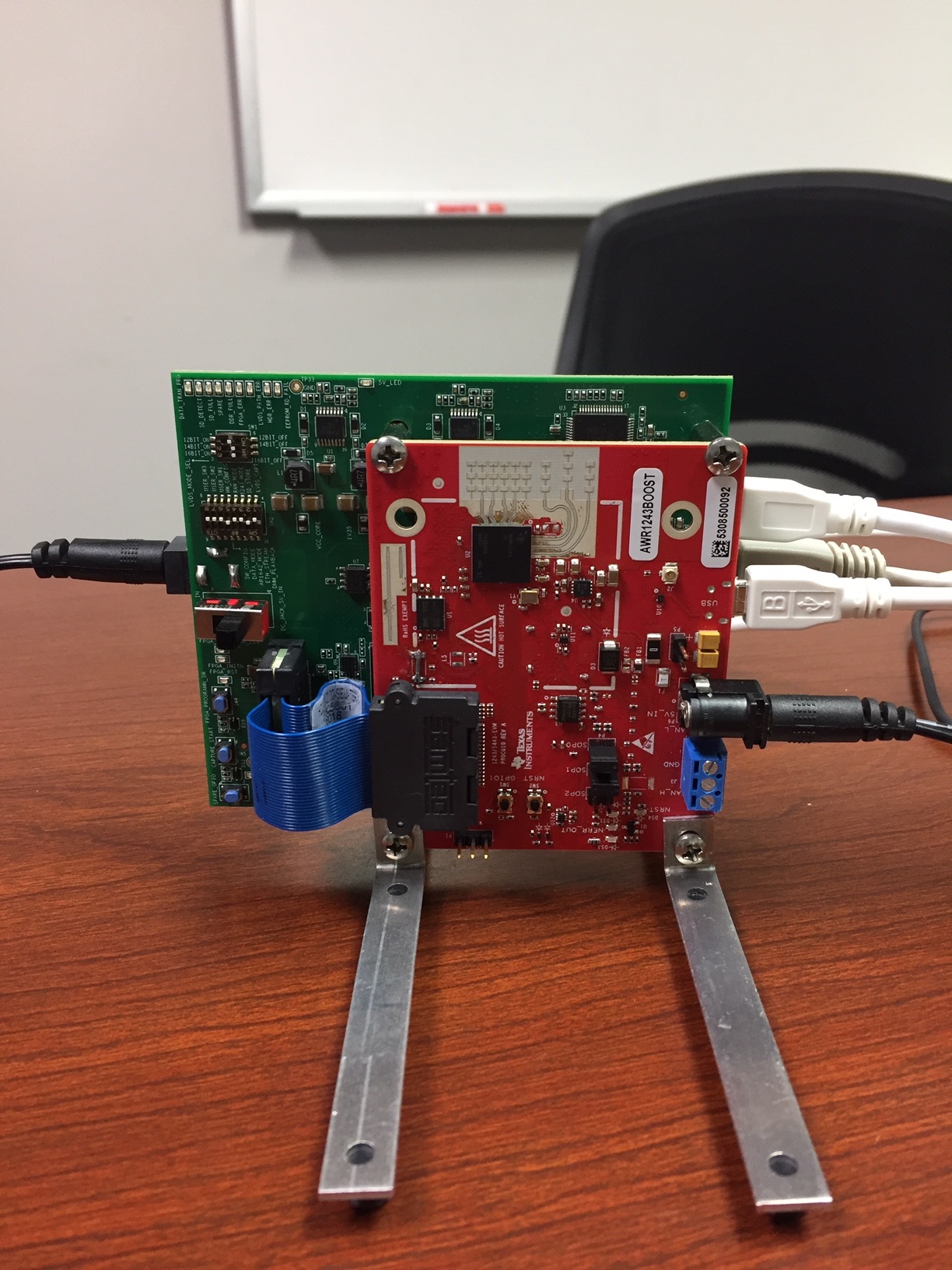

  • I'm attaching an image of the AWR1243Boost as mounted to the DCA board. I've checked all the cable connections are consistent with both the quick start guide and your email.
  • Attached is a photo of the radar chip.
    Line 4, 946D
    D = ES2.0
    I appreciate your help very much! Thank you.
  • William,
    Yes, your interpretation is correct. Your device is an ES 2.0 AWR1243. You should be using mmWave Studio version 1.0 since mmWave Studio version 2.0 only supports AWR1243 ES 3.0.
    It looks like your physical setup is correct as well.

    After I follow the steps and push the Trigger Frame button, I can see it highlights and dims the Post Process button.  The next button to be highlighted is the browse button next to the Dump File: block.
    I'm attaching a screen capture of the folder where the Dump File is currently pointed.
  • William,
    Based on the screenshot you provided, it does not look like your DCA1000EVM is capturing any raw ADC data. If there was any raw data collected, the "adc_data_Raw_0.bin" file would be non-zero. But your folder is showing it as having a size of 0 KB. So that leads me to believe that there is an issue happening with your data capture.

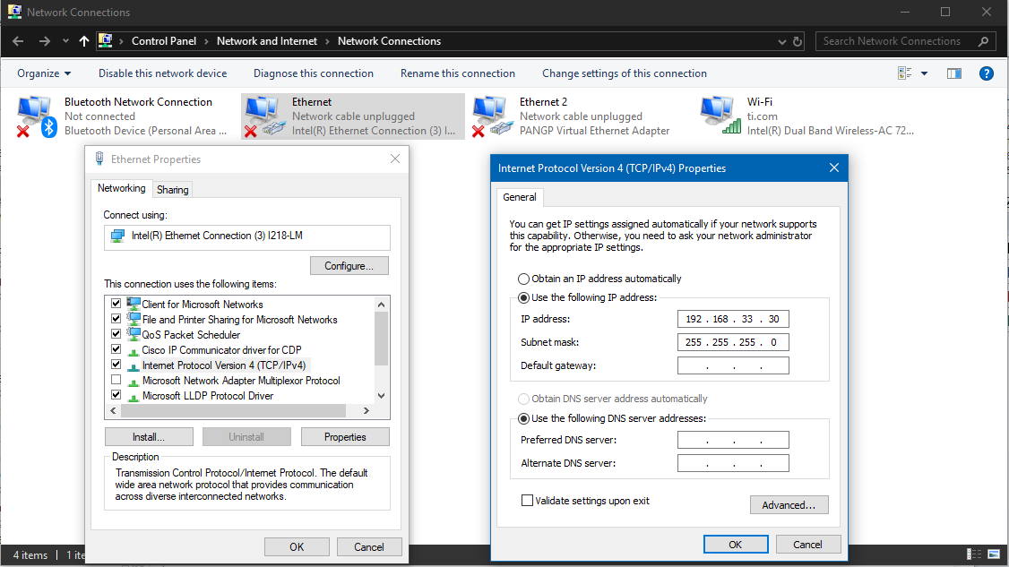

    In one of your log files, there was a warning message that said that your Ethernet cable was disconnected and to please check.
    Did you make sure to change the IP address on your PC to a hard-coded address of 192.168.33.30? This change needs to happen so your PC can receive the raw ADC data coming in over Ethernet.
    Kyle
  • Thank you. I have my Ethernet port set up correctly; however, I found it appears unplugged unless the board is powered on before I connect it to the computer. When I ensured that it was connected, I ran it and I got an error message referencing “LabView runtime”. Does that make sense?

  • William,
    If you are correctly connected to your DCA1000 through mmWave Studio, you should see the following image:
    You should also see the following output messages in mmWave Studio:
    [13:55:29] [RadarAPI]: ar1.SelectCaptureDevice("DCA1000")
    [13:55:29] [RadarAPI]: passed
    [13:55:30] [RadarAPI]: StatusDCCard Event Registered
    [13:55:30] [RadarAPI]: Status: Passed
    [13:55:30] [RadarAPI]: ar1.CaptureCardConfig_EthInit("192.168.33.30", "192.168.33.180", "12:34:56:78:90:12", 4096, 4098)
    [13:55:30] [RadarAPI]: SYSTEM_CONNECT_CMD_CODE Async event recieved(9)
    [13:55:30] [RadarAPI]: ConnectRFDCCard Status: Passed
    [13:55:30] [RadarAPI]: CaptureCardConfig_EthInit API Status: Failed, Error Type: RRFDCCARD_SUCCESS
    [13:55:30] [RadarAPI]: READ_FPGA_VERSION_CMD_CODE event recieved(14)
    [13:55:30] [RadarAPI]: ar1.CaptureCardConfig_Mode(1, 0, 1, 2, 3, 30)
    [13:55:30] [RadarAPI]: CaptureCardConfig_Mode API Status: Failed, Error Type: RRFDCCARD_SUCCESS
    [13:55:30] [RadarAPI]: CONFIG_FPGA_GEN_CMD_CODE Async event recieved(3)
    [13:55:30] [RadarAPI]: ar1.CaptureCardConfig_PacketDelay(25)
    [13:55:30] [RadarAPI]: CaptureCardConfig_PacketDelay API Status: Failed, Error Type: RRFDCCARD_SUCCESS
    [13:55:30] [RadarAPI]: CONFIG_PACKET_DATA_CMD_CODE Async event recieved(11)
  • Please make sure that you have correctly configured your TCP/IPv4 settings based on the screenshot below:
  • Thank you all again for the help.
    I believe my Ethernet is setup correctly.  However, when I attempt to Setup DCA1000,
    the FPGA Version shows only as 0.0.0.0
    Here's the setup of my Ethernet:
