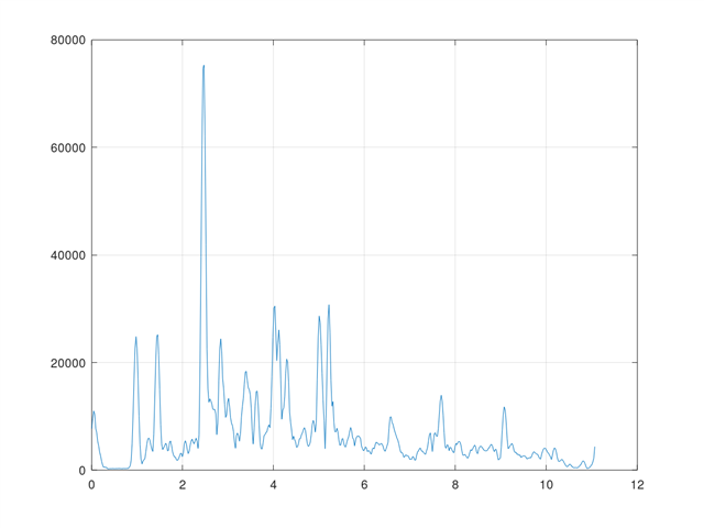

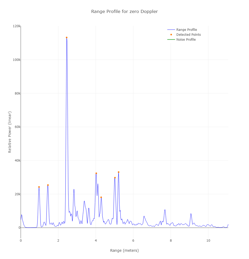

after analyzing the TLV type 2 (MMWDEMO_OUTPUT_MSG_RANGE_PROFILE ) data that is transmitted via UART, I have the following questions:
1. To what exactly are these values relative to? As they are labeled "power", can I somehow assign absolute mW/dBm values to the peaks?
2. Is the data obtained by one or multiple (virtual) receive antennas? If the latter one, how is it guaranteed that an object on the side is not "smeared" over distance as a consequence of different path distances?
3. I tried to plot the TLV data, but this results in different values than the ones the Visualizer is depicting. As you can see below, while the first two peaks have almost identical values in both plots, the largest peak has a value of more than 110k in the Visualizer's plot and less than 80k in my own plot. Where could this difference come from?

    2. As I understand, the range profile depicts the zero-Doppler column of the detection matrix. According to the doxygen, measurements from multiple Rx antennas are then summed non-coherently, meaning, objects might be smeared over adjacent range bins due to differences in path distances. Please confirm or correct.
    EDIT: Not detection matrix but radar cube. Still, this would leave two dimensional data, the range bins over the virtual Rx channels.

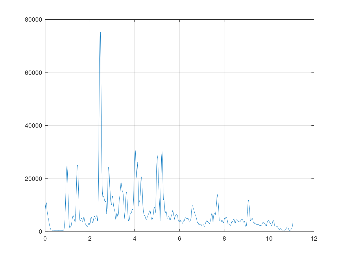

    3. I parsed the TLV file using a C#-script. After extracting the length of the TLV-item, i simply ran the following loop:
    UInt16 rp = System.BitConverter.ToUInt16(tlv_file, byteIndex);
    byteIndex += 2;

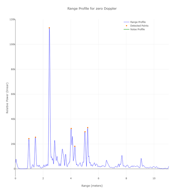

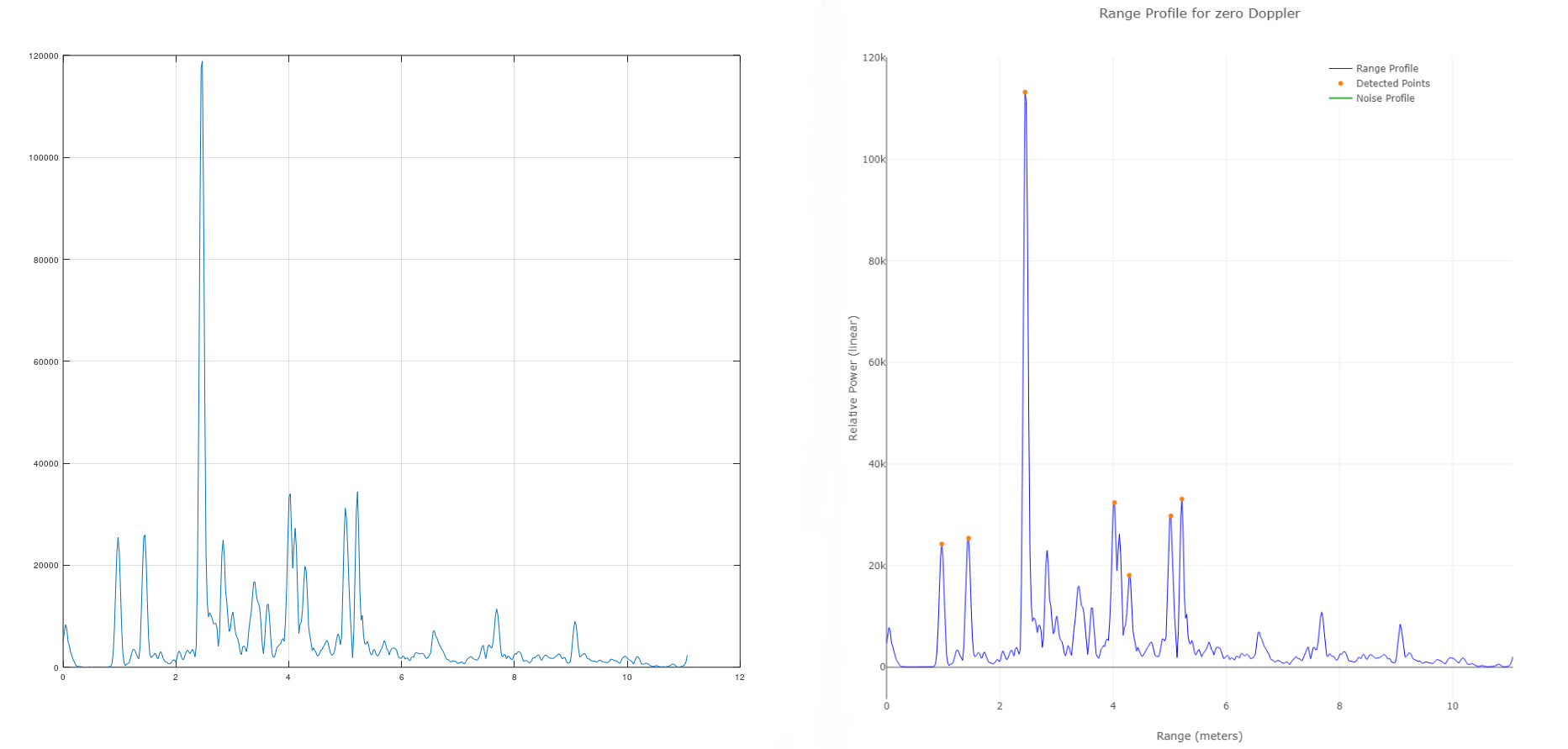

    I am very confident the data I get out there is correct. Subsequently, I read in the data in Octave and plot it. Originally, I just divided each value by 256 to convert from Q9 to float, which resulted in the plot seen above in my original post. However, I noticed that the Visualizer performs a comprehensive amount of processing on the values before plotting, maybe you can elaborate on why this is done? For example, I allude to the dspFftScalComp-functions.
    EDIT: I can see that this is also a topic in https://e2e.ti.com/support/sensors/f/1023/t/821420. TI, please comment on this.
    Nevertheless, I was able to plot the following, which is now closer to the Visualizer's plot, but not yet perfectly matching (Octave plot based on parsed TLV data and translated Visualizer source code on the left, original Visualizer plot on the right). As you notice, my own plot now gives values slightly larger than the ones depicted by the Visualizer.

    As you mentioned, the visualizer performs scaling on FFT data. During FFT processing on the DSP, the data is scaled to avoid overflow. My understanding is tha the visualizer compensates for that

    I'm still a little confused as to why my implementation of the Visualizer code produces values differ slightly from the ones the Visualizer depicts (see my post from Aug 19, 2019), but for now I feel content with the answers and my knowledge gained from them. You can close this thread if you wish.
