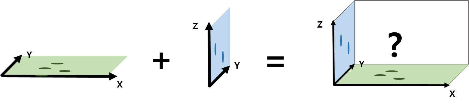

I’m trying to plot the 3D scatter of moving object using data captured using IWR6843ODS+ DCA1000 just like
http://dev.ti.com/tirex/content/mmwave_industrial_toolbox_2_5_0/labs/lab0016_zone_occ_14xx/docs/zone_occ_14xx_user_guide.html
and I have some question.
How does the 3D position of the scatter were found from 2D projections of objects?
From what I understand, the range-azimuth heat map will give XY-plane point cloud and the range-elevation heat map will give YZ-plane point cloud.
In many cases, the number of points detected in these two planes will be different
and matching YZ-plane point cloud and XY-plane point cloud only using Y position seems to be difficult.
I don’t know how to get XYZ point cloud from two 2D point clouds.

    3D point clouds are determined from performing angle of arrival estimation on the azimuth and elevation planes. With range, elevation angle, and azimuth angle - a 3D point cloud is arrived.
    Since you are using a DCA1000 for raw data capture you will have to implement your own code for processing the collected ADC data to extract a 3D point cloud. I would recommend studying the source code of the ODS point cloud demo.

  • I still can’t understand how to reconstruct 3D point cloud from range-azimuth angle information and range-elevation angle information.
    Does the demo assume that the 2 points in 2D planes (range-azimuth and range-elevation) with the same radius are a projection of the same point in 3D?
