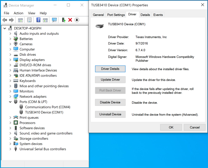

  • I see the TUSB3410 show up in device manager with driver version 6.7.4.0
  • Device manager also shows a generic "Communications Port"
  • When I launch the EVM GUI, the "Serial Port" dropdown box includes the COM port corresponding to the generic "Communication Port" device, but not the COM port corresponding to the TUSB3410
  • I can re-assign the COM ports in device manager, and the EVM GUI continues to find only the port corresponding to the generic "Communication Port"

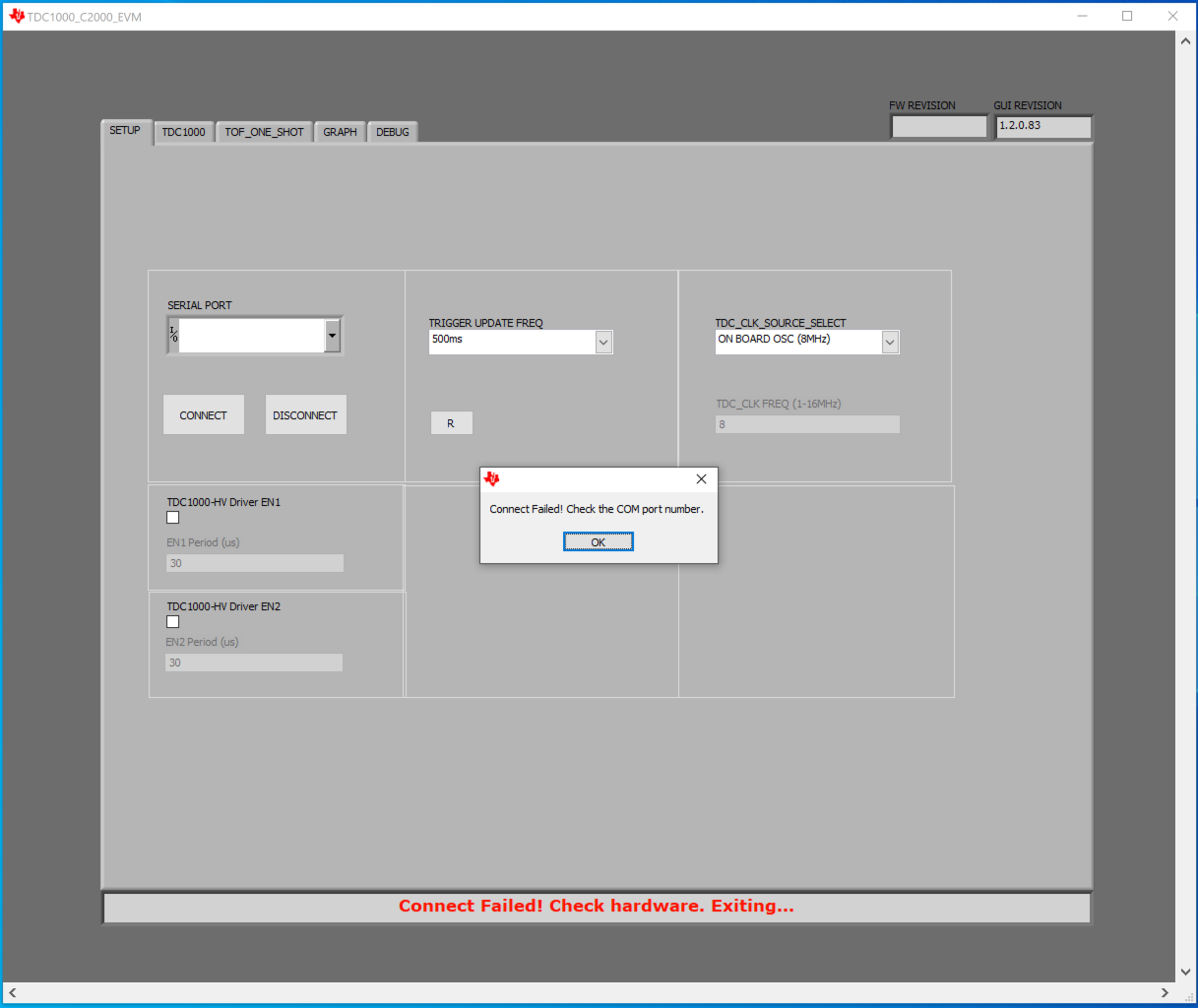

    When I connect the TDC1000-C2000EVM board to my windows 10 VM it shows up in Device Manager as shown below.  Note that the TUSB3410 is COM1 and some other generic device is COM4.
    When I first launch the EVM GUI, I immediately get the screen below telling me that the connection failed.
    What I find to be the most suspicious, is that when I go to the drop-down menu to select the desired serial port, COM1 does not show up at all.  The GUI is detecting that COM4 exists, but of course (since it's not the TI board at all) cannot connect to it either.

  • I briefly hijacked my wife's work computer (I haven't owned a windows computer in nearly two decades) and was able to get the EVM GUI to connect to the EVM.  Her physical computer and my VM show the TUSB3410 exactly the same within Device Manager, but one works and the other doesn't.  Go figure....

  • I have procured a physical Win10 machine, but I am now getting the following error when I try to run the EVM GUI.
    "The VI is not executable. The full development version of LabVIEW is required to fix the errors."
  • Neal,
    Do you know the difference in the systems wherein you were able to install this GUI and the system wherein you get this error.
    The GUI was originally designed to work in Windows XP & 7 and it will require a full version of the LabVIew Run time engine.
