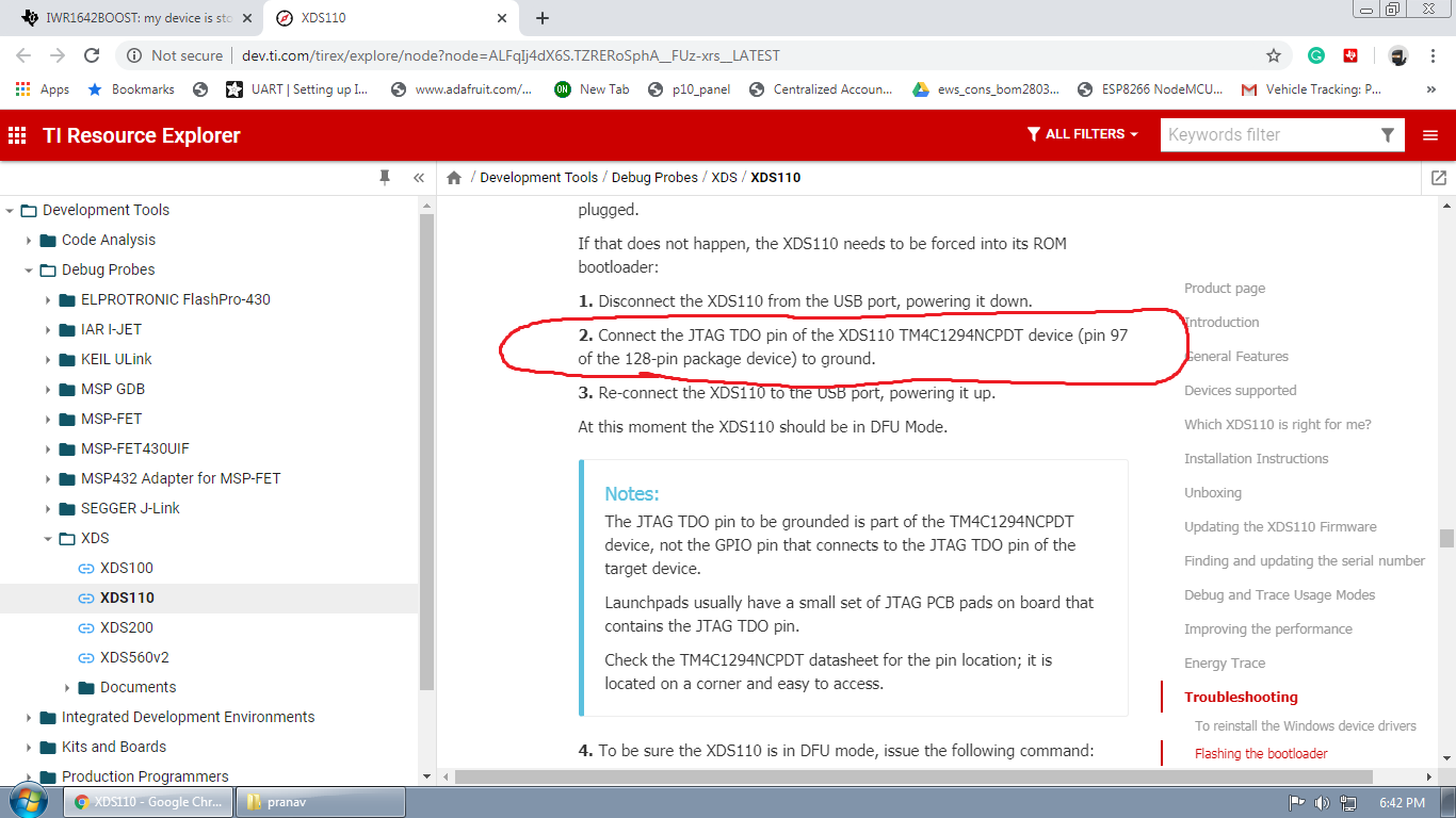

First I reinstalled the windows device drivers based on this link http://dev.ti.com/tirex/explore/node?node=ALFqIj4dX6S.TZRERoSphA__FUz-xrs__LATEST
but I didn't find the COM ports on device manager then I decided to flash a new bootloader to the device and
I found the following (marked red)
That's why I connected TD0 pin to the ground.
For me, it's difficult to troubleshoot the hardware, and it is very expensive to buy a new 300 dollar device again. What should I do?
Pranav Venu,
Thanks for the clarification, TDO pin you have referenced is, TDO pin of the XDS110 TM4C1294NCPDT device (pin 97 of the 128-pin package device) not the mmWave sensor TDO pin.
In 1642boost board TDO pins are not brought out of package boundary, Hence it is not easy to access it. It could be possible during this process there could be damage to TM4C1294NCPDT device.
