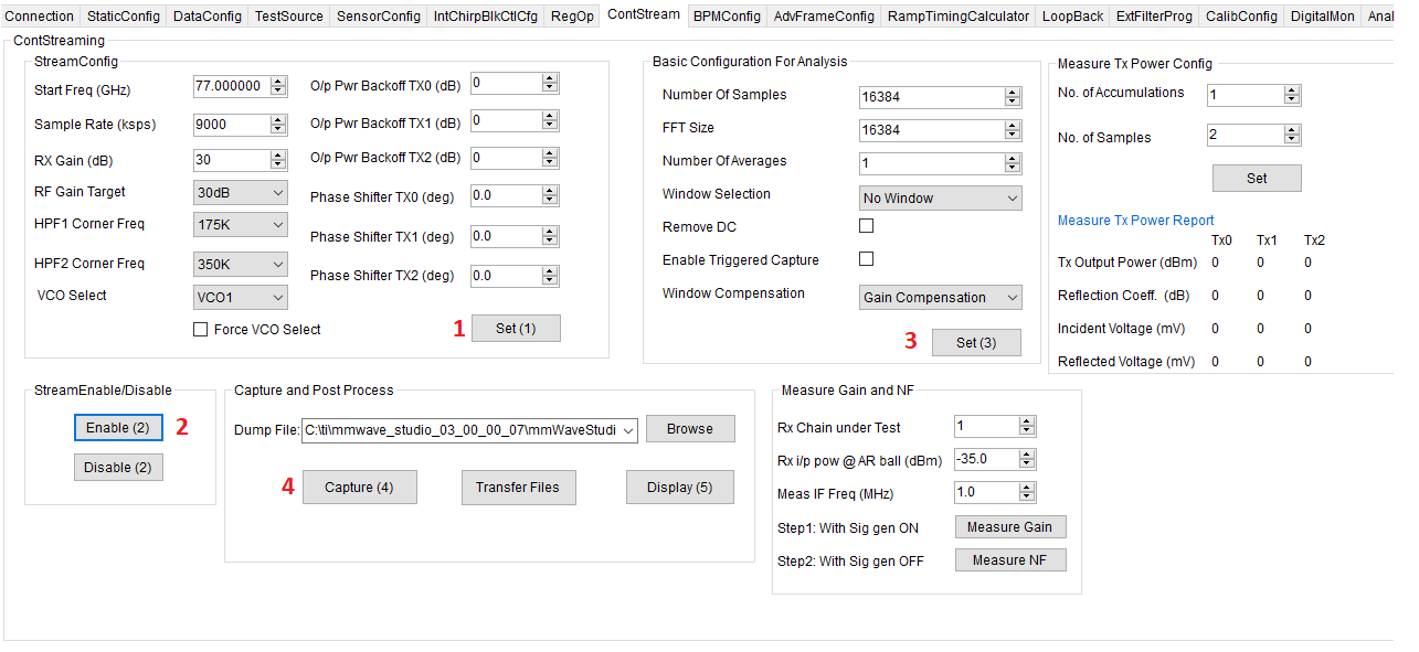

I would like to emit CW from AWR1243 Cascade EVK using one radar device.
I have been using "Contstream"tab of mmWavestudio2.01.00.00.
Is the following recognation correct?
Device starts to emit CW when I push "Enable" button after I set "stream config"
"Capture" button of "Capture and Post Process"  dose not  turn into "stop capture".
In this case,Device has been emitting CW but ,dose not capture.
Device can emits CW using following code of Lua language.
ar1.ContStrConfig_mult(UInt16 RadarDeviceId, ...)
ar1.ContStrModEnable_mult(UInt16 RadarDeviceId)
