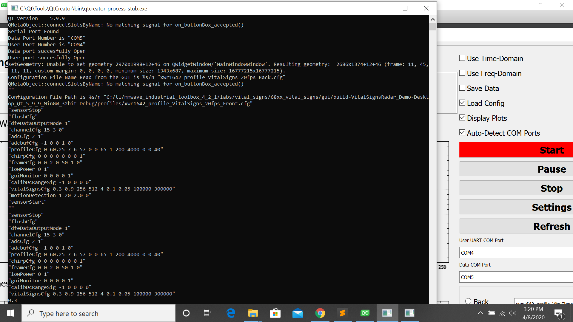

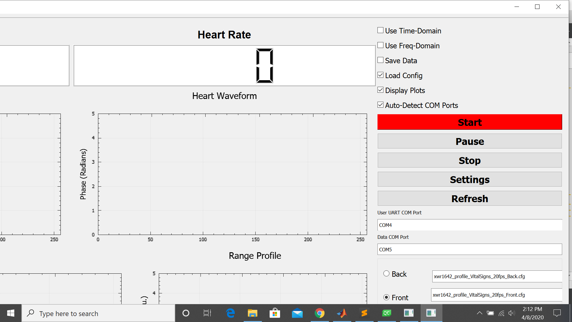

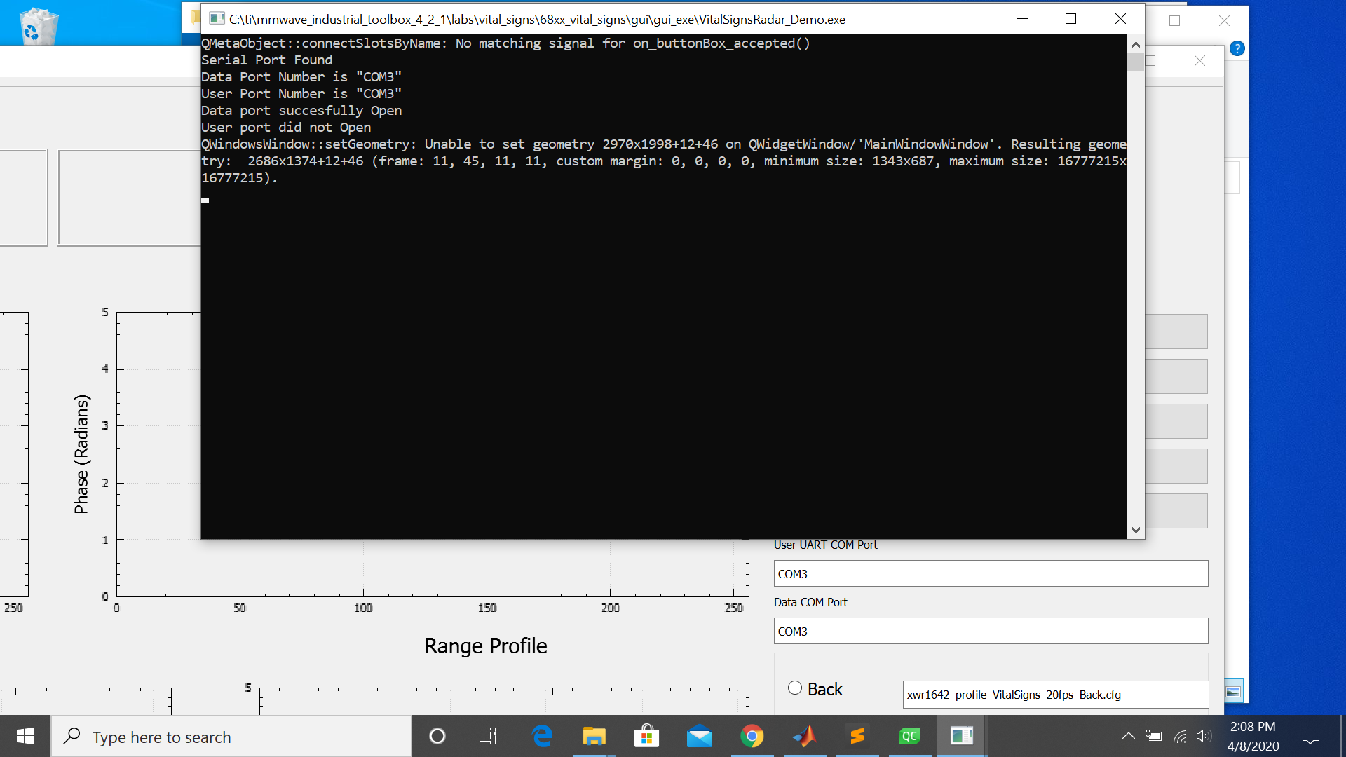

So I tried changing the GUI source code and setting the default port to be COM4 and COM5, however, it still doesn't show any plot, the results are shown as below:
I then also tried capturing data through the GUI and the recorded data file is empty, so I guess it's some setup errors...
I have set the board correctly(both SOP1 and SOP2 are at "off") and it can run the out-of-box demo, I have tried flashing the board with vital_signs_demo_68xx.bin  and vital_signs_demo_68xx_aop.bin and none of them worked. Does anyone know why and how could I fix this? Thanks for your help!

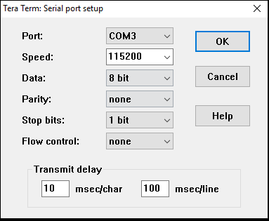

    4. Instead of using the GUI, connect Tera Term to the Control UART using the settings shown below (press enter a couple of times to make sure that you see the mmw demo prompt on the control UART port in Tera Term.
    5. Send the configuration commands in the provided .cfg file (C:\ti\mmwave_industrial_toolbox_4_2_1\labs\vital_signs\68xx_vital_signs\gui\profiles\xwr1642_profile_VitalSigns_20fps_Front.cfg) one by one
    6. Open another Tera Term Window and connect the Data UART using 921600 bps speed (keep all other settings the same as control UART).
    7. Do you see any data coming out (it won'be human readable) on the Data UART?

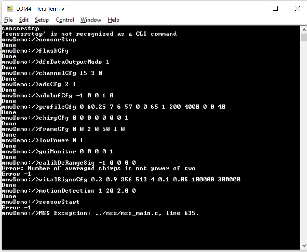

  • Hi Nitin,
    Thanks for the reply!
    1. I don't have a MMWAVEICBOOST carrier, is it required to run the vital sign demo? I can run the demo visualizer(https://dev.ti.com/gallery/view/mmwave/mmWave_Demo_Visualizer/ver/3.3.0/) without a MMWAVEICBOOST board. The setup I'm using is shown as below:
    2.I tried to use Tera Term to connect to the board,the control port is COM4 for me so I set it as COM4 instead of COM3 in your setup, and here is the commands:
    I opened another Tera Term window and checked Data UART(COM5) and nothing showed up.
    Do you have any ideas on how do I debug this or is it just because Vital sign demo requires a boost carrier? Thanks and I appreciate your help!
    Shirley

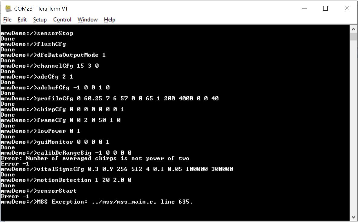

  • Hi Shirley,
    Thanks for providing this information. The TeraTerm log shows that the demo failed because of an exception in file mss_main.c at line 635. Did you make sure to Power cycle and Reset the EVM before starting the Vital Signs Demo?
    -Nitin

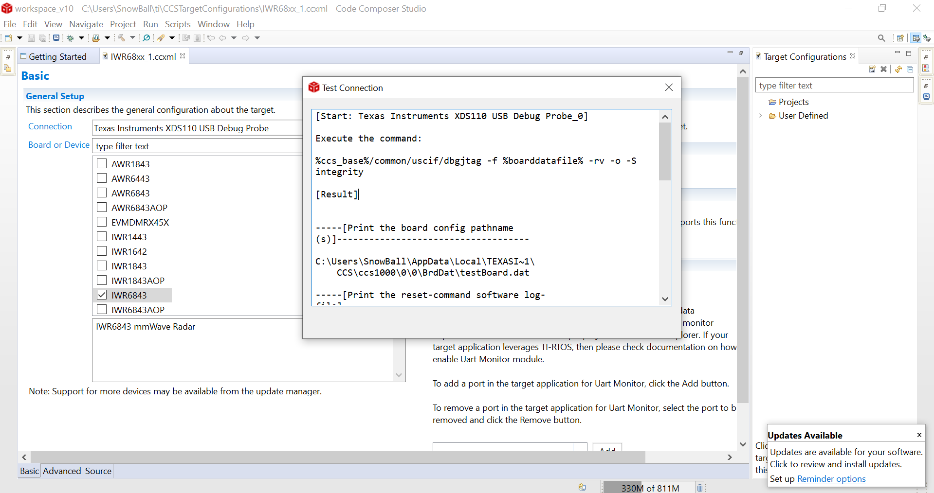

  • Hi Nitin,
    I tried the ccs debug mode following the instruction here:
    And I got an error when click the "test connection" after I finish the target configuration setting, the error is saying "An attempt to connect to the XDS110 failed". I did some search online and found that most people having this error because of bad usb cable, however, the usb cable I'm using can successfully run the mmWave online demo visualizer so I don't think my usb cable has any problem, do you have any idea or suggestions?
    Below are the screenshot and error log, thanks!

  • Hi Shirley,
    The Antenna module does not have the XDS110 JTAG Debugger on it so you cannot connect CCS to it directly. You need to mount it on the MMWAVEICBOOST card (which provides the XDS110 JTAG functionality) and follow the procedure for CCS debug mode as listed in the user guide.
    -Nitin

  • Hi Nitin,
    1. This is custom designed EVM.
    2. I run the demo using tera term by connecting CFG PORT to 115200 bps and DATA PORT to 921600 bps, and send the configuration via CFG PORT. No data coming in DATA PORT. After issuing sensorStart command it showing Error -1 and failing at line 635 in mss_main.c.
    3. Yes it is having JTAG.

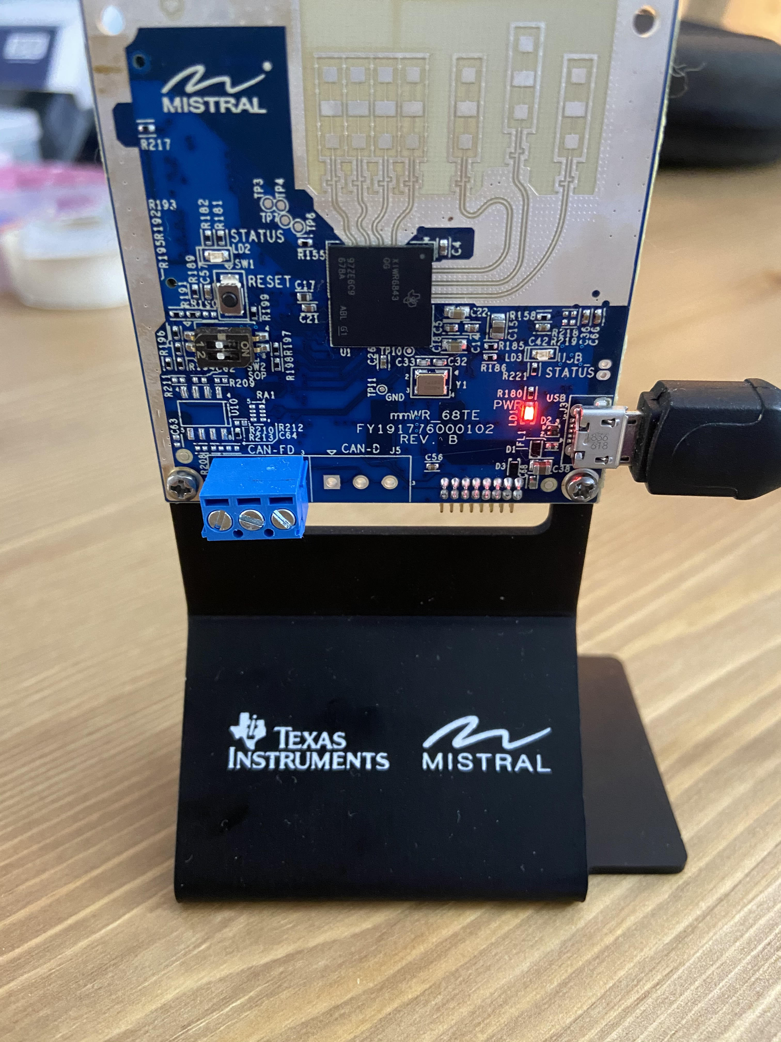

  • To further clarify, your EVM is not the same as TI's AOP EVM. I think this confusion is coming from Mistral's naming. Their name AoPCB means Antenna on PCB which is not the same as the IWR6843AOPEVM (where AOP stands for Antenna on Package).
    The AOP binary provided in this lab is built for TI's IWR6843AOP ES1.0 Silicon, while the IWR6843 Silicon on your module is ES2.0 so you may be loading the wrong binary.
    -Nitin

    Please refer to the following thread on the same issue:
    IWR6843: Sensor is not starting and capturing data when run Vital Sign Demo on IWR6843 based EVM
    As noted, the current Vital Signs Lab GUI only supports the UART COM ports exposed by the XDS110 UART controller (which is present on the MMWAVEICBOOST). The Mistral IWR6843 AoPCB EVM uses a different UART controller (CP210x) and the Vital Signs GUI does not work with those. So you will need to either modify the GUI to add support for the different UART COM ports or use an MMWAVEICBOOST as mentioned in the lab user guide.
    -Nitin
