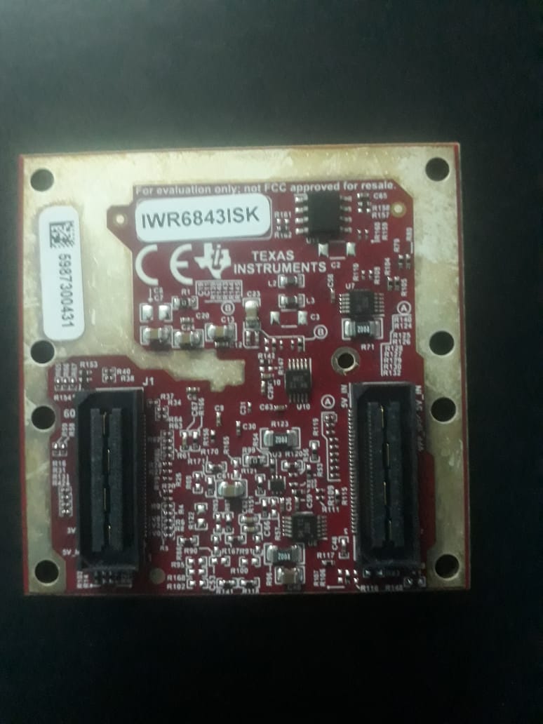

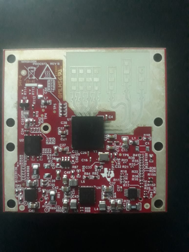

I am using the IWR 6843 ISK - ODS device for more than 2 months. There is booting issues with the Sensor, after flashing the .bin image. When i run the Demo Application(matlab GUI ),sensor start is not happening and it is not provided the frame Numbers.
And one more issue is, antenna color has changed due to more heat. Attaching the sensor image below FYI.
Here i will attach the power supply image also. Please guide me whether this power supply range is sufficient or more than that.
Help me out to resolve the problem.

         Board image you have posted is not of IWR6843ISK-ODS but regular IWR6843ISK, It need to be plugged with MMWAVEICBOOST board to work. Power adapter used seem to be fine.
    Is the problem is present on IWR6843ISK or IWR6843ISK-ODS board?
    Could you please post the image of the both the boards together under powered on condition when it does't work?
    Does out of box demo application run correctly?

    1.Board image you have posted is not of IWR6843ISK-ODS but regular IWR6843ISK, It need to be plugged with MMWAVEICBOOST board to work. Power adapter used seem to be fine.
         >>Appologize for wrongly sent, board is IWR6843 ISK.
    2. Is the problem is present on IWR6843ISK or IWR6843ISK-ODS board?
        >> I am not sure whether the problem is with ISK board or with MMWAVEIC BOOST carrier board. Please guide me how to find the issue.
    3. Could you please post the image of the both the boards together under powered on condition when it does't work?
         >> Shared the image of IWR6843 ISK device with powered and not working condition.

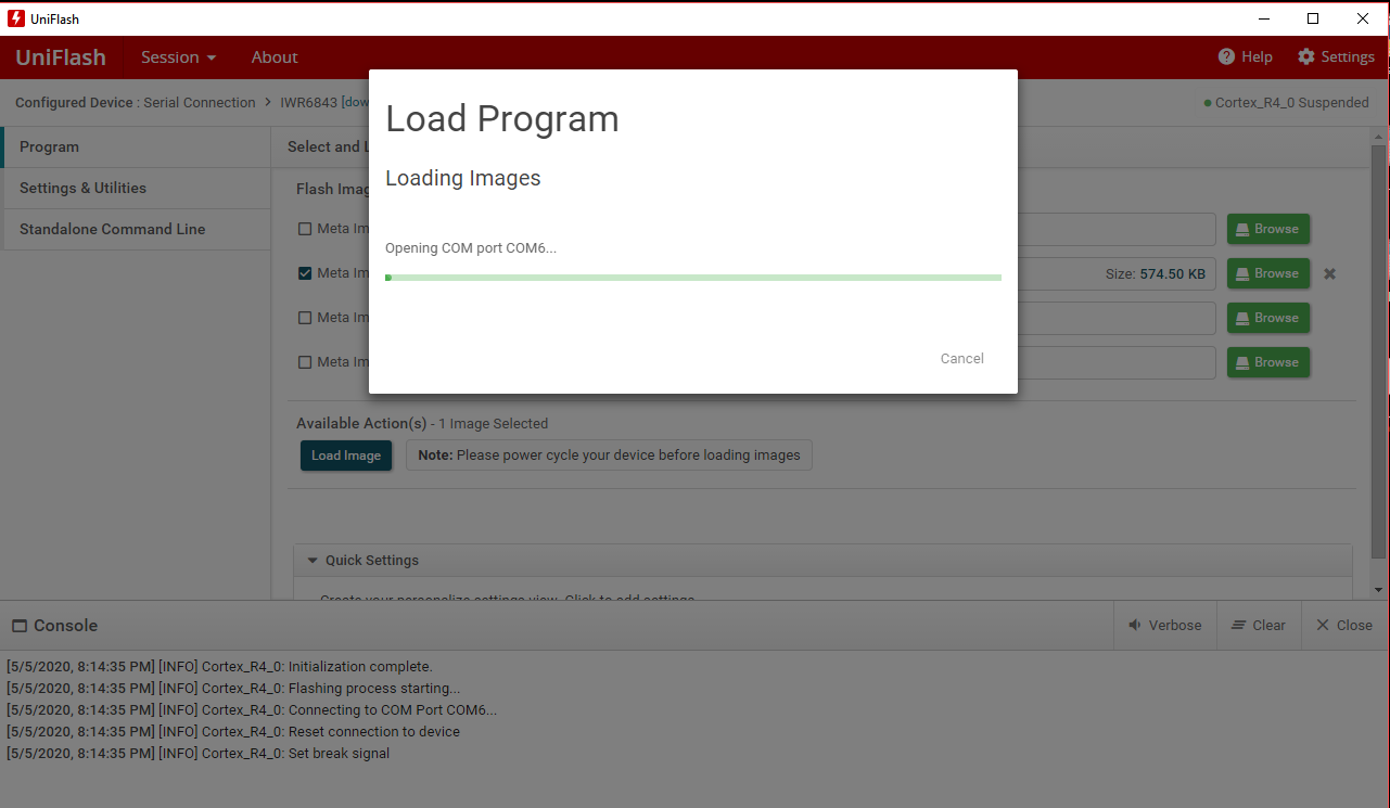

              >>Also sharing the uniflash tool stopped with "Opening COM_PORT" for your references.
    4. .Does out of box demo application run correctly?
         >> I cannot be able to flash the .bin file  now.

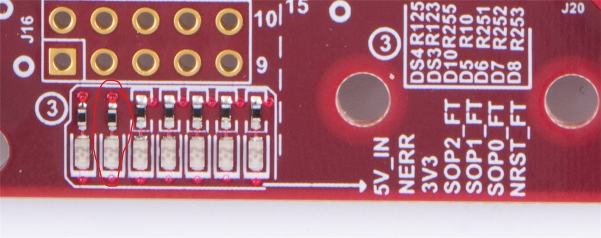

        Is NERROR Led is illuminated? From the picture it’s not clear. If NERROR is lit then there is some hardware failure is present.

  • Priyanka,
        On the bottom of the carrier board these are series of LEDs are present. Second from the left bottom circled below is the NERROR LED.
    From the above picture it's not clear if NERROR LED is illuminated or not.
    DS2 LED not glowing indicates some sort of hardware problem.
    For mmWave sensor to work there should not be any NERROR LED should be glowing.
     And sensor should be in right boot mode i.e. SOP2 (From the image it looks like device is in the right jumper configuration for SOP2 mode), After that a reset application is needed to register the boot mode.

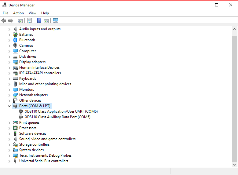

    Once boot mode is registered you need to use the right com port (Please post the com port configuration in the device manager).
    Also if you had any un-successful flashing in past, there could be residue of flash utility may be residing, it might block the ports, Hence terminate all the flash utilities in your task manager (including any python scripts *.py in the background) and retry flashing...
    >> Posting the Device Manager COM PORT config
