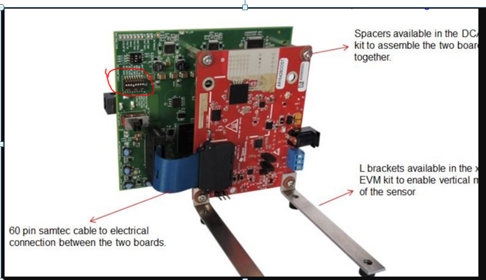

hi,
I'm using mmWave Studio(1.0) with DCA1000 EVM and IWR1443BOOST(ES 3.0).I followed the necessary steps, configured IP to static. 192.168.33.30. Everything was successfully configured, but when it comes to the data capture. there's a warning: Ethernet cable is disconnected, please check! After DataCaptureDemo_xWR.lua, there's a series of  adc_data file, but all of them are empty.
I tried to set mmWave Studio as an allowed app to communicate through firewalls, but it did not work.
I used wireshark to capture some packets, but there's noting when I set the filter ip.adr==192.168.33.30

[00:21:40]  [RadarAPI]: ar1.CaptureCardConfig_EthInit("192.168.33.30", "192.168.33.180", "12:34:56:78:90:12", 4096, 4098)
[00:21:40]  [RadarAPI]: Status: Passed
[00:21:42]  Ethernet Cable is disconnected Please check.....!!!
[00:21:42]  CaptureCardConfig_EthInit Success
