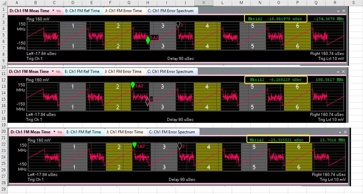

Hello, TI team,
I have a question about profileCfg for AWR1642.
I set profileCfg as follows:

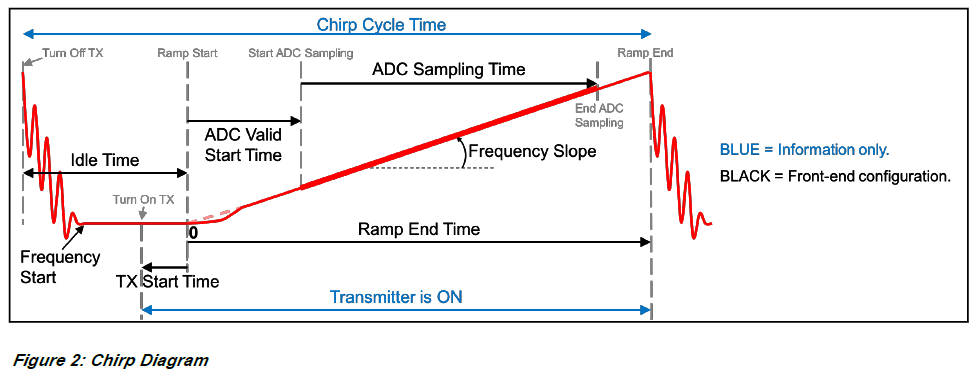

    profileCfg 0 76.1 7 7 18.24 771 0 10 1 64 6250 0 0 48
This means Idle Time is 7us, Ramp End Time is 18.24us, and txStartTime is 1us.

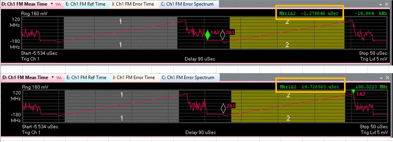

Then I tried observing the shape of the chirp output from AWR1642 by using oscilloscope with FMCW signal analyzing software,
and the result is follows.
From the result, it looks like Ramp End Time is 16.9us, and Idle Time is 8.3us.
(But Chirp Cycle Time is OK. Because 7us + 18.24us is 25.24us and observed time was about 25.3us)
Do you have any ideas why there is difference between profileCfg and real wave form?
