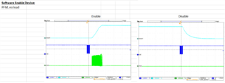

  • I can see the out SW toggling. but what is the difference between EN and software enable bit 5?
    if bit 5 of 0x03=1, SW =LOW
       bit 5 of 0x03=0, SW=HIGH
    what about EN it is also device ON and off right so, if I set EN=0, then SW=0, and EN=1, then SW=1 ???
  • Hello Pushpa,
    the EN pin and the Software Enable Device (bit 5 in Control Register 0x03) should be equivalent.
    What do you mean by SW=1?
    I would expect a rectangular waveform at the SW pin if the device is enabled.
    Have you also observed Vout?
    Here is a screenshot from our validation for reference.
    Andreas.
