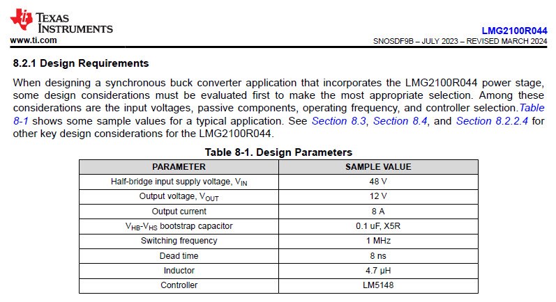

    When I look into the datasheet SNOSDF9B_July_2023_revised_March 2024 of part LMG2100R044 at page 15.
    I see that the controller is the LM5148 and the Dead time is 8nS, is this the minimal set value of the LM5148?

  • Hey Stephan,
    Apologies for the delay, I can still help answer some more details, but I need to pull in the controllers team to help label exactly all of the features that work and do not work when pairing LMG2100 and LM5148 together
    I do know that the deadtime will not be 8ns, please disregard this section of the datasheet as we are working to update it. Normally the buck controller will use adaptive deadtime control, but this feature is turned off when connecting SW to GND, so deadtime will default to 100ns I believe.
    This is a very suitable controller to pair with LMG2100, and we have a reference design using it: PMP31349
    Additionally, we have a reference design using two single GaN devices in a half-bridge configuration with LM buck controller: PMP23392

  • Hi Stephan,
    By utilizing the LM5148 and the LMG2100 together - the main change that you are doing in the controller operation is connecting the SW to GND which disables the Deadtime circuitry of the controller. The deadtime will now be managed by the GaN device. I don't think any other functionality will be affected by this implementation (as can be seen by the Functional Block Diagram as well).
    As Zach shared earlier, you can look at the https://www.ti.com/tool/PMP23392 which is a proven design and seems to be very similar to your requirements. The test results of this design are also available in the above link.
