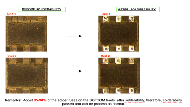

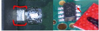

We discover a wettability issue on this component. After investigation, we have observed that the plastic package of the component covers the edge of pins and avoid a correct soldering on pin edges as requiered by IPC-A-610.
We would like to ask Texas Instrument to optimize their component encapsulation process by sparing these tab edges, which will allow better observation of the soldering quality as well as mechanical performance.
Attached some pictures to describe the observation
