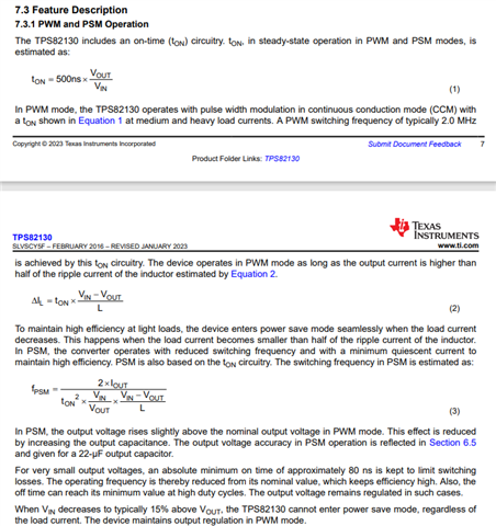

1. Please tell me the current value that switches from PWM to PSM. In the case of 12 V input and 2.5 V output, I read from the graph of efficiency vs output current that it switches at 500 mA. Is this correct?
2. Please tell me if there is a way to calculate the current value that switches.
3. Is this current value determined by peak or bottom of ripple current?
