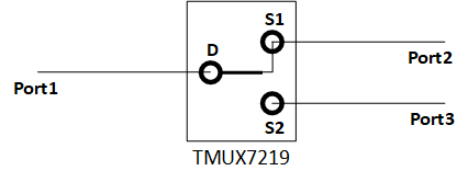

  • Hi Bryan,
    Thank you for your support.
    1)
    the provided s4p File contains following data for above position of the Switch D-S1
    S11 :Port 1 Return Loss
    S21,S12 :(Port1 - Port2):insertion Loss data is available
    S13,S31 :(Port1- Port3) :OFF Isolation data is available
    S14,s41: :Port 1 - Port 4 Which Parameter  is covered ?
    How  can we evaluate Crosstalk between Between Port2 and Port3 ?Is it covered in Provided in S4p file? if it is covered which Sxy(S parameter data) data can be taken for Cross talk.

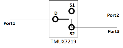

    2)
    Please  provide s4p File contains following data for above position of the Switch D-S2 also.
    Pin 1(D) to Pin 8 (S2) :insertion Loss (Port 1 to Port 3)
    Pin 1(D) to Pin 2 (S1) :OFF Isolation(Port 1 to Port 2)
    Pin 2(S1) to Pin 8 (S2) :crosstalk (Port 2 to Port 3)

  • Vasanth,
    As I mentioned in my previous post, Port 4 is not connected to anything.
    For crosstalk, that would be able to be evaluated using the S23/32 parameters.
    Again, I provided what S-parameter models we have for the voltage range/temp that was requested.
