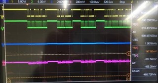

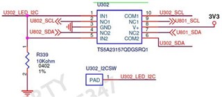

We occur the issue using TS5A23157-Q1. Below is our connection. We used TS5A23157-Q1 to switch the I2C signal. (400kHz)
Below is the config.
SW = 1
CH1: U801_SDA, CH2: U801_SCL, CH3: U802_SDA, CH4: U802_SCL

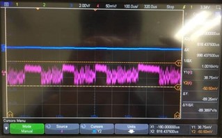

We find U802_SCLK has coupling noise from U801CLK or U801 SDA.
Remove chip and find the result is ok.
The occurring rate is 1/4. We did the A-B-A swap and find the issue is followed by IC.
Could you let me know how to fix it?
