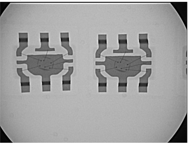

Hi, Pls see the following picture, the same origin, different location of positioning hole, please help answer, thank you!
DC: 2117, COO: CN This is our supply
DC: 2119, COO: CN Customer's goods

Hi Renee,
These are both valid versions of the device.
We have multiple assembly sites for this part - see below.
Assembly sites can vary in how the IC is assembled and both of the assemblies shown are ones that are valid for this part.
