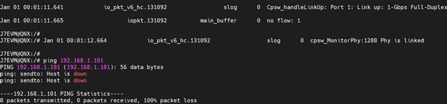

J721E: cpsw2g: The ping is failed after ifconfig am0 when it under the FD1000 mode
Hi sir
     Our CPSW2G use the Marvell 88e1512,
     After "ifconfig am0 192.168.1.12 up", and the phy is linked but the ping is failed.
    But after I re-plug the network cable, It can ping successfully. Please help check this is why? how to solved this issue?
    1. Did you run any command before ""ifconfig am0 192.168.1.12 up" ?
    2. Which SDK version is this ?
    3. Can you run ethtool -S am0 and send the output ?
    4. Is the link up on Marvell switch as well ?
    I can try and simulate on my EVM (I am assuming that you are running QNX
    Vineet
  • Hi sir
        I run the below command before "ifconfig am0 192.168.1.12 up"
    slog2info -c
    slog2info -w&
    io-pkt-v6-hc -d cpsw2g
    if_up -p am0
        The SDK version is j721e-evm-07_03_00_07
       we are running the QNX, and there have no ethtool
         Yes, the link is up. I have captured a log which have attached.
    Yes, we are running the QNX+TIRTOS.
    Thanks!

    J7EVM@QNX:/# ifconfig
    lo0: flags=8049<UP,LOOPBACK,RUNNING,MULTICAST> mtu 33136
            inet 127.0.0.1 netmask 0xff000000
            inet6 ::1 prefixlen 128
            inet6 fe80::1%lo0 prefixlen 64 scopeid 0x1
    am0: flags=8843<UP,BROADCAST,RUNNING,SIMPLEX,MULTICAST> mtu 1500
            address: b0:b1:13:45:1c:bd
            media: Ethernet none (1000baseT full-duplex)
            status: active
            inet 192.168.1.12 netmask 0xffffff00 broadcast 192.168.1.255
            inet6 fe80::b2b1:13ff:fe45:1cbd%am0 prefixlen 64 scopeid 0x11
    J7EVM@QNX:/# ping 192.168.1.101
    PING 192.168.1.101 (192.168.1.101): 56 data bytes
    ping: sendto: Host is down
    ----192.168.1.101 PING Statistics----
    9 packets transmitted, 0 packets received, 100% packet loss
    J7EVM@QNX:/#
