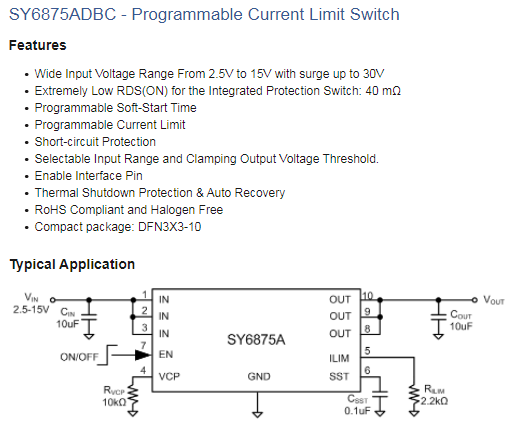

There was a request for a replacement product recommendation from a customer due to the delivery issue of the following parts.
- SY6875ADBC / SILERGY
Please recommend TI products with specs similar to the above parts.
The required specs are as follows.
- 12V 2A input
- Voltage clamping 16V or less
- Current limit: 2A or more
- Undervoltage lockout : 3V or less
For the specs of existing products, please refer to the following.
Thanks.
