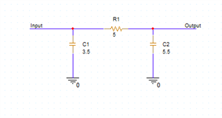

    Even with an unencrypted file (which would require an NDA) the syntax would vary between the HSPICE file and LTspice.
    A passive model will also do the trick in LTspice. It's a pretty simple approximation. In the onstate it would look like this :

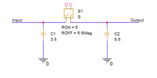

    In the off state you can replace R1 with a 5.5Mohm resistance this should give the worst case off state leakage at 5.5V (using ohms law, R = 5.5/1uA leakage).
    If you want to add switching capability that can represent the logic, you can introduce a voltage controlled switch if it's available in the place of R1 and drive the logic with another source.
