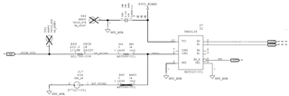

I would like to ask about unexpected output of using TMUX136.
I have the clock generator at the input of COM1 , with the EN_N is controlled by the dip switch to turn on/off TMUX136.The output of A1 and A2 are floating.

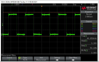

When EN_N is pulled LOW (dip switch is OPEN), TMUX136 is turned ON with the clock output is observed at A1 only. And no output at A2.

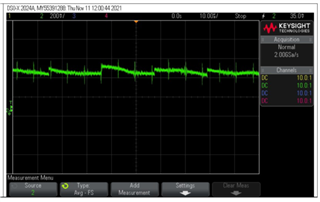

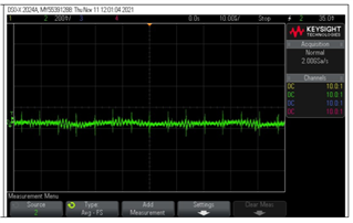

However, with EN_N is pulled HIGH (dip switch is CLOSE), TMUX should be OFF and no output is observed at both A1 and A2.
There is DC voltage ~400mV is observed at A1. Could you advice what can be go wrong with this unexpected output ?
Thank you.
When EN_N is pulled LOW (TMUX 136 is ON)
When EN_N is pulled HIGH (TMUX should be OFF)
