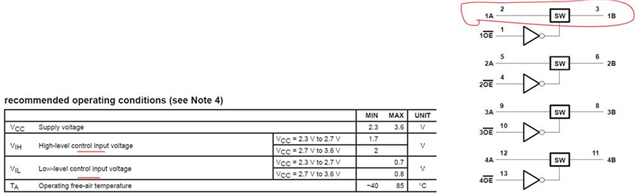

Customer is consulting whether our SN74CBTLV3125 can support 1.8V I2C signal application? If not, do we have any P2P device to recommend here? Thanks.
I check the D/S the VIH seems tight here regarding to 1.8V.

    Thanks for reply. Let clarify customer's question here, does A-switch-B can support 1.8V I2C signal for SN74CBTLV3125? For OE control pin, customer will use separate power to control.

  • The control inputs should use the VCC voltage.
    The switch I/Os are analog, and support any voltage between GND and VCC.
  • Hi Stanley,
    You could use the SN74CBTLV3125 here, but you would need to make sure you use a supply voltage between 2.3V and 2.7V and the logic voltage stays above 1.7V (note we guarantee the logic will register a logic high at 1.7V or above, so as long as you are confident your logic signal is 1.8V, there will not be a problem). If you can have separated supplies at those voltages, I see no issue here.
    If you are still a little uncomfortable with using this device, you can also take a look at the TMUX1511 which is basically a refreshed version of this device and will have more margin for operation and better performance (P2P, but note the logic is reversed).
