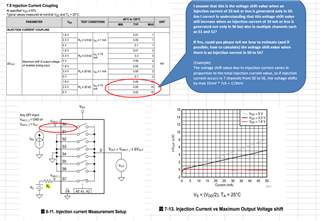

I have got some question from our customer and I would like to have your help.
Q1) I assume that this is the voltage shift value when an injection current of 10 mA or less is generated only in S0.
      Am I correct in understanding that this voltage shift value will increase when an injection current of 10 mA or less is
      generated not only in S0 but also in multiple channels such as S1 and S2?
      If Yes, could you please tell me how to estimate (and if possible, how to calculate) the voltage shift value when there is an injection current in S0 to S6?
      (Example for calculation)
      The voltage shift value due to injection current varies in proportion to the total injection current value, so if injection current occurs in 7 channels from S0 to S6, the voltage shifts by max 15mV * 7ch = 119mV.
      Please see the figure below:
Your help is really appreciate.
