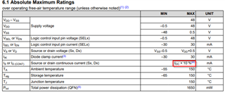

now customer evaluated TMUX7236 instead of ADG1436, Please confirm whether the single switch overcurrent of the switch chip is the value below,if yes, customer will use it , so please kindly confirm it , many thanks~

Hello, Cooper
The picture you have provided show the specs for the recommended maximum current that can pass through the chip and guaranteed accurate performance that is reflected in the data sheet. Is this what you are looking for?
Note that: the absolute max before damaging the device is in the data sheet below:
