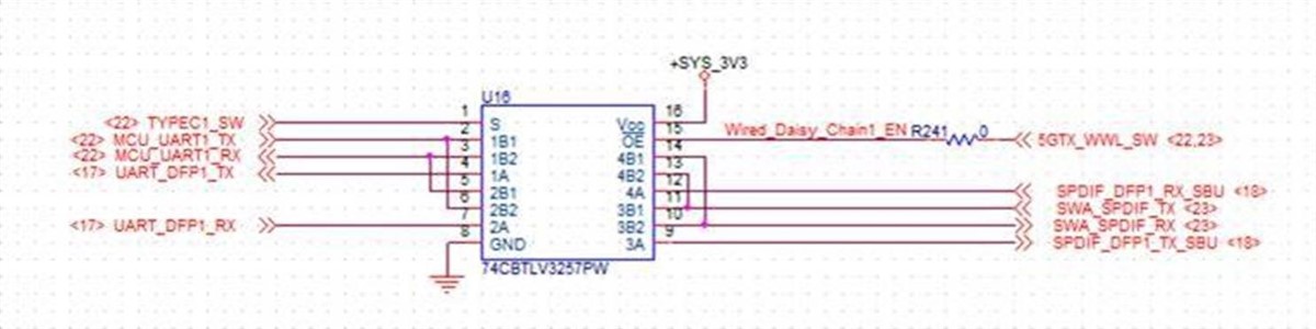

Does SN74CBTLV3257 suitable for audio spdif switch?
My customer using Neperia 74CBTLV3257 meet some distortion issue, I have apply TI part for test,
But still want to check it can use in this application or have better suggestion.
