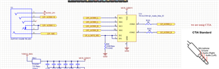

Hi Expert,
Please review the below schematic, we are using TS5A22364-Q1 as audio mux feeding two laptop audio aux signals as shown in image. Those output stereo of selected laptops from mux are going to RC4580 OPAMP.
Question are I didn't get any signal on output side when I plug the aux cable into audio aux connector.  Am I doing anything wrong? Where to connect the 1st pin(GDN) of audio connector?

    I'm not seeing anything that particularly stands out. Can you send some waveforms of the I/O's and the power supply?
    I'd recommend to tie your pin1 GND (GND_LP1) to the system ground. So the same ground that the 22364 device is using as ground.

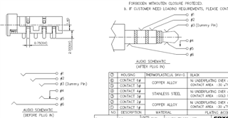

    I think technically your pin 3 should be your tip (audio left) and pin 4 that you're using is used as a bias for pin 5 which would be a detection pin but electrically speaking, the way you're doing it should be fine since you're shorting pins 4 and 5 together. It probably isn't a problem but figured it wouldn't hurt to bring up too.
    Rami
  • Hi Rami,
    The pinout of aux jack as shown in the image. Pin no. 3 won't be the issue for this circuit.
    Though, I give pin1 of aux connector to common GND of system.

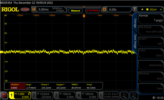

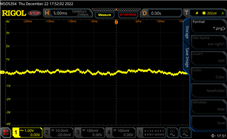

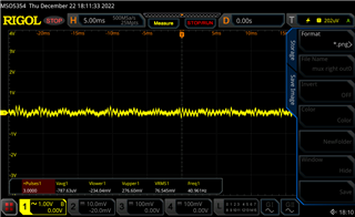

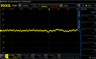

    Please check some waveform of audio signal on scope: Input left of aux connector
    Input Right of aux connector
    Output of TS5A22364-Q1 Left audio
    Output of TS5A22364-Q1 Right audio

  • Mohit,
    This looks like noise on both ends and some noise filtered out at the output. Are you actually applying an audio signal on the input? Or is this just extremely zoomed out relative to the scope of the audio signal levels?
    Can you bypass the mux and see if there is audio there to start?
    Can you probe the supply and the control pin as well with the input/outputs. Having them on the same graph vs multiple individual waveforms would be preferred here too.
    Rami
