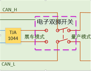

Can SN3257-Q1 be used as a switch for CAN signals?

The SN3257-Q1 can be used as a switch for CAN signals if the voltage on any input doesn't exceed 5V (with a 5V supply). Note the current limit on this device is +/-25mA through a channel so you should have no issues if those factors are in line with your application needs.
Please let me know if you have any other questions!
