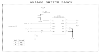

Hi team,
My customer is facing a pop noise at the TS5A22364 Audio SW. They are using TS5A22364 to SW two single ended signals. So they are using only one channel and unused pins are left floating.
Could you please review below schematic and guide me to reduce pop noise? They said the pop always happens when selecting any inputs.
+The pop also audible when there's no input at all.
