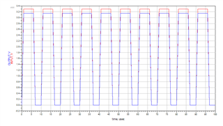

    That being said, I did do a very quick and barebone simulation on the model in ADS to ensure that it does function and I did get a signal to go through as you're looking for.
    So I don't believe it's an issue with the code but something with how it needs to be setup within Ansys itself.

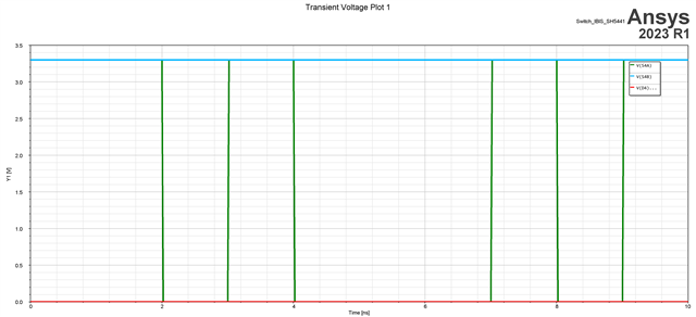

    Thanks for the reply. Yes, different tool might handle the model differently. Here I try to post some snipped pictures of ansys import:
    This is if I import as component
    Then I can set the pins into different terminator options, for example here:
    Then I set the circuit as this
    And I got the result as below. The signals doesn't pass through, so D4 kept low.
    Could you see anything that suspecious? I will try to reach out to Ansys as well, but there aren't much that I could set here in the tool for the switch.
    BR
    Li
  • Hey Li,
    I can't really see anything that stands out as an obvious solution.
    My only thoughts that I can add here are that typically I select two pins for the signal path while here it looks like you can only select 1.
    Additionally, did you change the code to comment out the 1.8V rail and uncomment out the 3.3V rail? The default state is 1.8V. The '|' to the left of the line indicates commenting out
