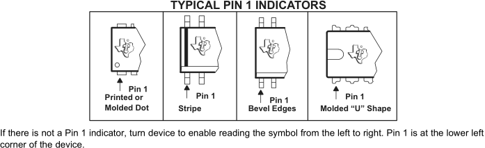

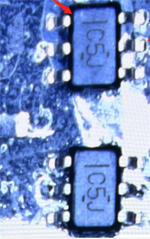

The polarity point of this product SN74LVC1G3157DCKR is displayed as a small dot in the data table,
but the product we purchased does not have a small dot, it is just a short line.
Is this line a polarity point? Which one is Pin1?
Please refer to the attached image and look forward to your reply. Thank you
