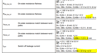

  • The TS5MP645 has no specifications for I/O voltages above 1.3 V, not even typical values (see figures 1/2/3). I suspect that this device uses only N-channel pass transistors, i.e., the switches have much worse characteristics or do not work at all near the positive supply.

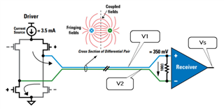

  • Hello Lei,
    In the LVDS there are two communication lanes, one transmits and the other receives and they are both connected to some kind of a receiver.
    Please see diagram below with V1, V2 and Vs highlighted:
    In order to have a common mode of 1.25V. V1, V2, and Vs need to be at a specific voltage value. To find those values the following equations can be used:
    V1 = Vs/2 + 1.25 (I noticed I put a "-" sign instead of "+", in my original reply, that was a mistake)
    V2 = 1.25 - Vs/2
    VDD doesn't affect the common mode voltage. The voltage difference on the two lanes and the voltage on the receiver affect it.

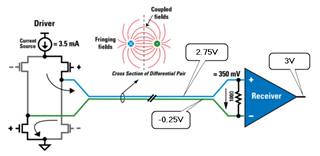

    For example:
    Let's say in the system, you set the voltage on the receiver (Vs) to be 3V, and since we are trying to have a common mode of 1.25V:
    V1 = 3/2 + 1.25 = 2.75V
    V2 = 1.25 - 3/2 = -0.25V
    So we get the following system with a common mode of 1.25V:

    The main question now is when V1 is more than 1.4V (higher than MIPI), is there any requirement for TS5MP645 VDD?
    As mentioned, all the DC characteristic is measured below 1.3V? Can you guarantee the same performance when V1/V2 is higher?
  • Hi Lei,
    I think Nir's equations are correct but the value he used for Vs was much higher than your application it seems, if you Vs is 0.35V, your equations are correct and the peak voltage is 1.425 V. That should be ok as long as the VDD > 1.425V.
    You are correct that the conditions in the datasheet are only up to 1.2V, but the device will still function up to 3.6V on the I/O pins, according to the Recommended Operating Conditions.
    What speed (GHz) are you planning on running your LVDS? The bandwidth of the TS5MP645 will degrade with the higher V1/V2 so I can't guarantee it, but if the device bandwidth is much higher than application it should be ok.
