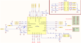

DP83825IRMQR OSC not working CMOS
We are using "DP83825IRMQR" one of the ethernet converter design and using with CMOS "ECS-250-12-33Q-JES-TR" oscillator as source clk for phy chip. Almost 2 months over we are not able find the problem of the oscillator  issue and not  able to find oscillator  25Mhz clock source between pin 12 & 13. Please find the attachment of my design circuit for reference.
Please help to provide the steps to analysis this issue to fix.
