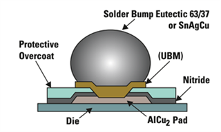

My customer is in need of information on the UBM (Under Ball Metallization)/SRO (Solder Resist Opening) of this device TMUX1575YCJR.

Hey Austin,
I've reached out to the packaging team for an answer here and will relay it back to you when I hear from them

Hi Austin,
Internal sources show that it is 0.185mm for this dimension.
