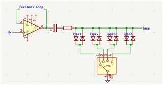

I would like to control with a MCU the set of clipping diode in a distortion effect unit.
Board is powered with asymetrical 0-9VDC and audio signal is peak to peak max 7V without any DC offset.
CD4052 looked promising but after checking datasheet it seems that it needs asymetric power to handle my audio signal.
If my asumption regarding CD4052 is correct, is there any other chip that oculd fullfill my need ?
Please let me know if any of my point is unclear.
