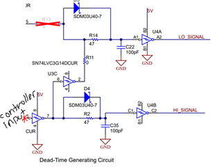

I have a controller that only has one enable pin. I would like to know if there is a single pin control input mode for the LMG2100R044 so that I can interface with this controller.
If so, what does the pin configuration look like for the I/O?
