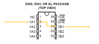

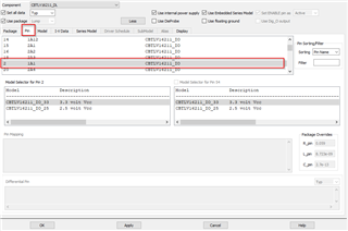

    Since it is possible to measure, please tell me how to connect the circuit diagram for waveform analysis.
    The customer is using Keysight ADS.
    How can I connect the SN74CBTLV16211 1A1 (2 pins) and 1B1 (54 pins) IBIS models to observe the waveform including the effects of passing through the bus switch?

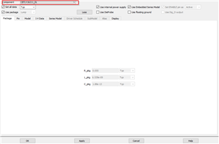

  • Hello Ishiwata,
    First download the IBIS model on TI.com.
    Then in ADS you look for the IBIS_Pin component. Double click on the component to open this window:
    Select a component

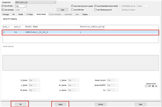

    Go to pin and click on pin 1A1
    Go to series model where you should see pins 2 and 54 are selected, then click and apply and ok

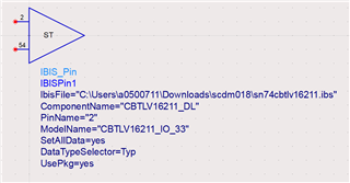

    This will result in this model

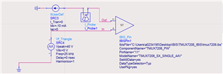

    Now you have the model where the two pins are connected. You can use basic components to create a circuit and run simulations.
    Here is an example making a circuit to test Ron (this is for a different part, but the setup will be the same).
    For further information on ADS I recommend searching online for tutorials on how to use the software.
