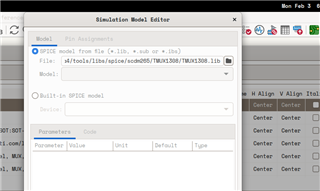

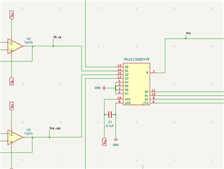

Hi! I'm new to simulating TI devices. I'm trying to simulate the following circuit in KiCad. I have a TMUX1308 Symbol which takes in 4 analog inputs on it's Source 0 to 3 pins (S0-3). The rest of the Source Pins are grounded. The Drain Pin (D) is connected an ADC. Vcc is 5V and A0,A1,A2,!EN are driven by a MCU (thus these logic pins are connected to the MCU's GPIO).
I download the TMUX1308 PSpice model from the official page here.  I then loaded the TMUX1308/TMUX1308.lib file into my KiCad's Simulation Model Editor for the TMUX1308 symbol (i.e. the TMUX symbol shown above).
In the "Model" dropdown, there are tons of options and I don't know which one's the right one.
I selected the "SWITCH_S0" model because it made sense (use S0 signal on drain) and ran a DC Sweep Analysis.  I then got errors & I'm not sure why but here's the logs and the spice netlist that produced the logs,
Note: Compatibility modes selected: ps lt a
Circuit: KiCad schematic

.title KiCad schematic
.include "/mnt/sda4/tools/libs/spice/scdm265/TMUX1308/TMUX1308.lib"
.include "/mnt/sda4/tools/libs/spice/sloj066/TL071.301"
.save all
.probe alli
.dc V4 0 1k 100m
XU4 Net-_U4-+_ /V100-1000 VA+ VA- /V100-1000 TL071
XU3 Net-_U3-+_ /V10-100 VA+ VA- /V10-100 TL071
R4 Net-_U3-+_ GND 10k
R5 Vin Net-_U4-+_ 200k
R6 Net-_U4-+_ GND 1k
R3 Vin Net-_U3-+_ 191k
XU5 GND GND /VTM GND GND Net-_U5-/EN_ SWITCH_S0
C3 Vcc GND 0.1u
V1 Vcc GND DC 5
V2 VA- GND DC -12
V3 VA+ GND DC 12
V4 Vin GND DC 2
XU1 Vin /V0-5 VA+ VA- /V0-5 TL071
R2 Net-_U2-+_ GND 10k
XU2 Net-_U2-+_ /V5-10 VA+ VA- /V5-10 TL071
R1 Vin Net-_U2-+_ 10k
.end
