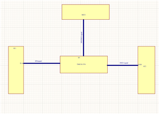

I have attached a screenshot of TMUX1574 can it work when both SPI and SWD signal in same channel for switching.
can I switch CLK signal of SPI protocol with S1A and other S1B connected with SWD protocol Data signal.

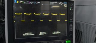

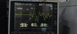

When I connected the programmer through the programming chip, it didn't show any errors. However, when I connected the TMUX1574 between the programmer and the programming chip, the programmer showed a blank check failure. What does this error mean? If the TMUX1574 is connected in between, it shows an error. Could this be due to signal loss, and what should I do to fix it?
Image with TMUX 1574 IC at (IC1574 D1 Pin) CH1 at Programmer PIN and TMUX 1574 IC at (IC1574 S1A Pin) CH2 at MCU PIN comparison
IMAGE without TMUX 1574 IC Programmer pin and MCU pin same connection
voltage level and frequency are also shown in image and IC supply is 5VDC
Please suggest !
