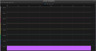

4. Logic analyser is a cheap 24Mhz 8-CH Logic analyser from Saleae

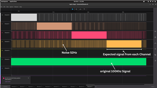

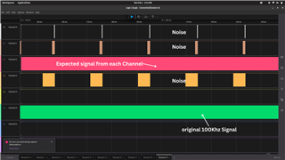

i also attached the Logic analyser output of the Channels below
To go into the deeper insights of the noise we observed
1. the noise is not the same all the time, sometimes the channels were very clean
2. we very often observed 52Hz noise even though the system is running off the Grid with an Unplugged Laptop.
3. Noise also seems to be inducing from the actual 100Khz signal we supplied to all Channels
4. if we ignore the noise, we are receiving the 100Khz signal as expected
5. the noise is persisting even if we added 10Kohm pull up resistors to the Channel lines just after the Mux
6. we observed the same issue with TMUX1208, TMUX1104

    and below are the images with Mux and Without Mux
    Left side : with Mux attached in the setup    |    Right side : Without Mux in the Setup
    Channel 0 - 6 : Mux Data Lines  (image)
    Channel 7 : Original Input Signal  (image)
    and yes your understanding is correct, Noise is not consistent, but most of the times we observer this constant noise of 52-53Hz
    From the above observation, the Noise is leaking from the Mux to all signal lines, but need your insights on it
