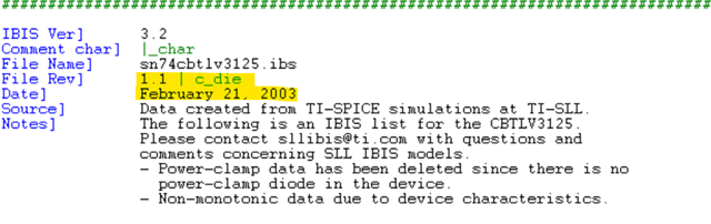

Please find the revision details of sn74cbtlv3125 IBIS file in the image attached,
With this IBIS file, we could not assign the pins of cbtlv3125_PW component to input or I/O as it is not defined as shown in the next image. We do not have model selectors in cbtlv3125_pw(highlighted in red) as available in the cbtlv3125_dbq(highlighted in green) component
Please share the updated IBIS model.
Vinothkumar S
  • Hello Vinothkumar,
    This seems to be a miss on our part. We don't have an updated version for this model.
    I recommend using the DBQ package version. There shouldn't a big difference between the packages.
